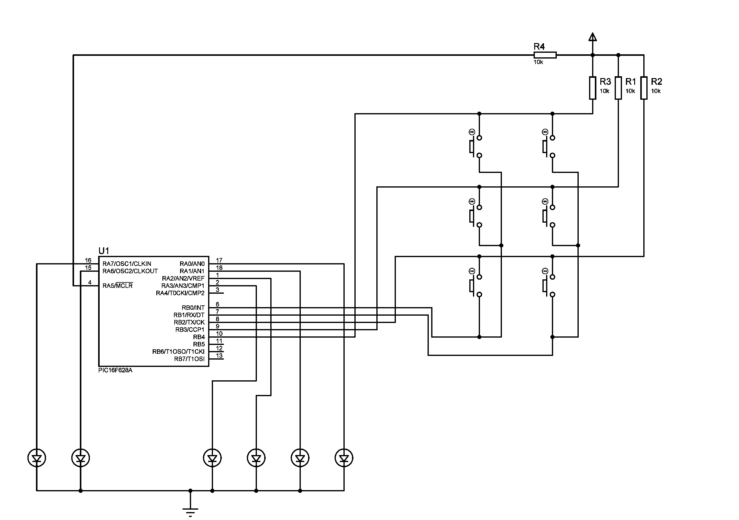

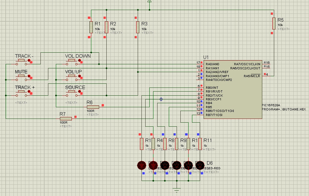

    I made a simple schematic for testing my remote control stalk near the steering wheel, from Renault.
    I use "KeyPad_2.bas" , addapted to my hardware :

    Allways LED's on PortB.2 and PortB.3 are ON ! What I am doing wrong ?!? Thanks in advance for reply !

    Problem solved...by moving ALL rows and columns to PortB ...

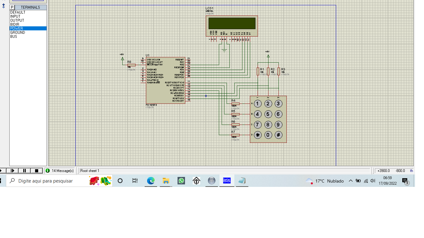

    ABOUT THE ROUTINE WRITTEN BY MR MISTER_E.
    I NEED HELP HOW TO MAKE THE NUMBERS ARE IN SERIES EXAMPLES 12345566
    AND THEN PRESS THE BUTTON # SEND VIA SERIAL A SEQUECIA.

    You may add the keypresses to an array using an index and then send the array over the serial port.
    Not tested but you get the idea:
    string    var byte[9]
    index1    var byte
    start:
    For index1=0 to 8
    @ READKEYPAD _myvar
    	string[index1]=myvar
    next index1
    if myvar="#" then hserout [STR string\8]
    goto start
