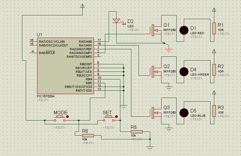

    Hi Sougata,
    If I enter any pause in the interrupt routine (I just tried it) I severelly impair the PWM loops, and this is another indication that the interrupt is being triggered constantly.
    Here is the schematic:
    Pablo
