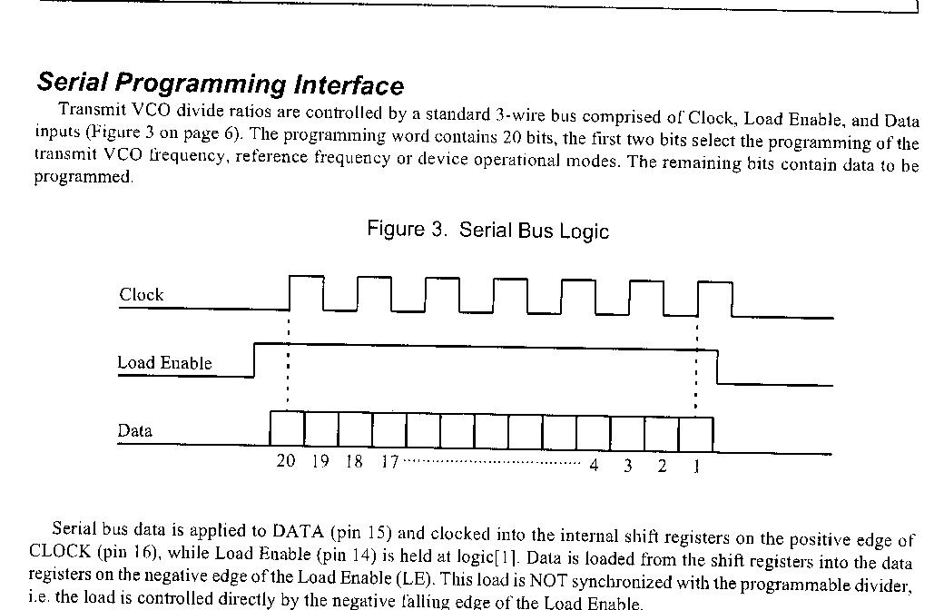

    Exclamation Clock is not synchronized
    Thank You Keith,
    I have now another problem;
    Clock and data is not synchronized. Clock pulse is 50% slowly. Must be clock seperated with data?
    Can you help me and write routine for this shift?
    I use PIC10F202 whith internal clock.
    please see attach file
    thanks, regards
    Samo
