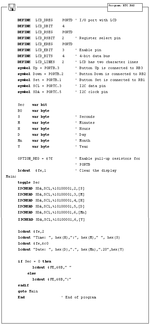

    Hi Peder,
    I dont think reading the chip every second should be an issue; I have used a PCF 8563 in a propeller clock that gets polled far more frequently, and there is no problem.
    I am attaching a snippet using PBP with the PCF8583 that I had downloaded some time ago; this might lead you in the right direction.

    Hi ardhuru,
    Would it be possible for you to post the rest of the code for the RTC including time setting? I think many people on this forum would be interested as there have been some posts requesting specifically this chip.
    Thank you very much!
    BobK
    448
    Default RTC read and RTC write
    Hi Bob,
    Actually, I used the PCF8563, which is virtually identical to the PCF8583 except for a few features.
    Anyway, here are the RTC read and RTC write segments that I use. Since my RTC works on a battery (a CR2032, now in its second year, expected to go on for at least a year more!), I have also extracted the low battery indiactor bit.
