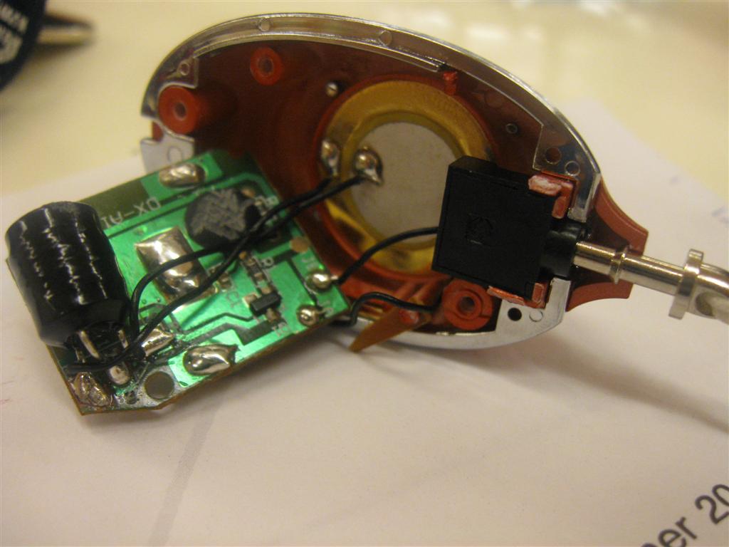

    Question
    Every so often I find myself buying products just to find out how they work... Recently I bought a cheap battery powered Piezo alarm...very small and quite loud...
    (I believe it's sweeping btw. two frequencies to be even more
    audible...so it's probably a piezo transducer.)
    I'm looking for help in figuring out how they made it so loud.
    (The audio jack is being used as a switch...alarm goes on when
    pin is pulled out...pin is stopped from coming out via housing...nice hack)
    I will draw up a schematic soon... here some pics
    Unfortunately I've never seen the critical part in question (black with 3 pins).
    I'm guess I'm looking at a transformer? inductor?
    Can anyone give me hints towards reading material or electrical tests I can do to find out more...
    Looks like the large 3 pin part might have heat shrink around it. Is that the case? If so, can you cut it off, and see a part #?
    Unfortunately no part number... just a bunch or really fine coils... I tried to be careful but I cut through them.... Perhaps I'll buy another unit so I can find out how many coils etc... but I guess we have an answer. I am not familiar with transformers. Logic tells me this one has a comon ground...input is boosted drive the piezo at higher voltage... I did a very brief search of farnell but didn't find anything similar... Anyone know part numbers or supliers of small 3 pin tranformers?
    It's a coil (inductor) to generate flyback voltage. There's a switching circuit that creates a high voltage to apply across the piezo element. Piezo elements are generally designed to be run at high voltage; 30-200V is not uncommon. In a really good design the piezo will also be in a Helmholtz enclosure as well to really get everything from the system as a whole. Years ago I designed these things for car alarms. 120dB was on the low end of what you could achieve...
    Do some searching on piezo elements; off the top of my head I'd say have a look at Murata. I seem to recall that they have some pretty good doc's on these things.

    I have taken apart a kitchen timer, and it has a similar circuit to the piezo buzzer mentioned earlier in this thread. There is a large inductor coil attached where the buzzer is.
    In this picture:
    http://www.picbasic.co.uk/forum/atta...9&d=1264966885
    Can someone tell me what is the purpose of Q1? Looks to be a surface mount NPN transistor.
    One of the leads to the piezo is always high, and the other one seems to be attached to the collector (not emitter!) of this transistor with the emitter going toward the IC through R1, although I could have my pinouts wrong.
    How does the IC control the PWM going to the piezo by means of the transistor?
    In this picture:
    Thanks!
    You've got the pinout wrong... the 22K resistor is on the base, the emitter looks to be tied to ground (check it with a meter). It sounds like the piezo is in the collector making it an open collector. You can tie the coil in parallel with the piezo to get the same flyback effect that Mark_s was talking about. Again, it's resonant so you have to play with the frequency to get it to "go"...
    Apr 2010
    3
    Quote Originally Posted by mtripoli View Post
    Thanks, after some more research, I realized the true pinout.
    Actually, what I am trying to do is to remove the coil and piezo entirely, and have the transistor act as a switch to turn on and off a higher voltage (3.3volts) that will be fed to the input pin of a PIC. Therefore, when the kitchen timer goes off, the PIC will read the PWM output as a digital signal to run a routine prior to resetting the kitchen timer to start counting again.
    What I have come up with so far is to disconect the coil from the transistor's collector, mount instead a 3k3 resistor between the collector to PIC VDD (3.3V) and connect the PIC input pin on transistor's colector. With the emitter of the transistor connected to GND (I will ground the PIC to the CMOS circuit). That way, when the timer goes off, it should trigger a "buzzer" that in non audible, but compatible with the VDD voltage that my PIC can read digitally.
    This is a timer circuit to snap the shutter on a Cannon SLR camera, and I have found that using the kitchen timer is cheaper than it would be to buy the LCD and buttons needed build the circuit completely based on a PIC.
    A digital Canon SLR? If I recall, there is a group of pads inside the the battery door. Bridging these pads results in focus adjust and shutter release. I used a 1K resistor (or something) to play around with this. I was going to make an RF remote control for my camera but got side-tracked with something else (about 5 years ago). There's a bunch of info on the net about this stuff. I think you can use just a relay to do this...
    I'm missing the point of using the kitchen timer. You can do everything you want with just the PIC...
    Apr 2010
    3
    The point of the timer is an LCD screen and push buttons for $2 at local discount store.
    I have already created one that is solely pic based, sets the camera off on intervals based on a potentiometer, from 1 to 255 seconds. I was next going to install and LCD screen with push buttons to do it all digitally, and found that the kitchen timer is cheaper than buying those parts individually.
    The timer has button that when pushed at the end of the cycle, restarts the timer. Essentially, the button is connecting a pin on the CMOS to the VDD of the circuit. I may be able to use another transistor and have the timer reset itself without even using a pic...
