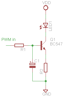

    Now then, I need to use a PWM frequency of about 20khz (in case you're wondering the LED still seems to react ok at this frequency!) ...this is beacause the LED will be going into an audio circuit & past attempts have proved that the PWM signal bleeds into the signal very easy so low PWM frequencies are out ...the kludge is to put it above the hearing range of most......at 16Mhz, a 20khz signal gives 800 bits of resolution, so what I'm wanting is for some maths savvy person to give me a hint at how I would use a LUT for 800 values in a way that would make the LEDappear to be fading up/down linearly?

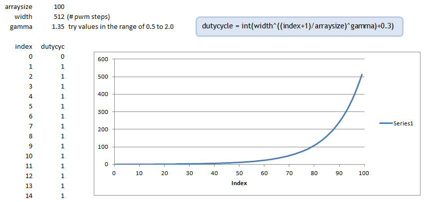

    here's the vibe I'm try to get (ie the data above plotted on a graph)...

    What kind of math did you use for your excel graph? Wondering if we can get close to that without a lookup.
    It wasn't that slick...nor scientific - basically I was after an anti log type of slope...now when it comes to maths & trig, I'm an epic fail - the only excel function I could get to work was Excel's 'log' (I'm not particularly familiar with excel either!), so I simply dragged down the rows to 512 - applied the log formula (log (A1,512) ...which gave me all the log values ....I then inverted the result in Excel (there's got to be a better way, but I work with the tool & knowledge constraints I have - I don't have time each time I hit a problem to park up & learn how to do it the right way!)
    So basically it's an anti log.....but I'd imagine doing the calculation in in PBP, would be like having your kneecaps drilled, then filled with salt & vinegar.

    Do you have any freedom to make hardware changes?
    PWM controlling the current of the LED will give the best results.
    So you could use a PWM output to drive a programmable constant current which in turn will drive the LED.
    It sounds complicated but is not that much. Look at the schematic.
    PWM output is filtered and drives the transistor that operates as a constant current driver. Current is controlled by R2 and should be selected to satisfy max LED current.
    R1 and C1 be 5-10 times the PWM frequency.

    That works a treat...many thanks :-)

    Ioannis ...that sort of what I'm doing - but rather than a tranny I'm using a mosfet (no filtering either...since the end result is visual, and the eye is only good for about 25Hz ....my pwm is about 16khz...so I didn't see the need?)
    4,179
    Default Re: Linearizing an LED for 800 pwm steps'?
    There is no difference (significant at least) whether you use bipolar or mosfet since the transistor will work in linear region. So, since it works linearly, cap will make calculation easier, because you will have to deal with dc voltages in base of the transistor in regard with the ground.
    So, after PWM fltering the resulting dc voltage is the sum of Vbe (~0,6) and V(R1). V(R1) will define the current through the LED.
    Have not tested in comparisson with the table but seems easier to control.

    Have you tried using fewer discrete brightness level steps spread across the much larger pwm width? For example, I get very smooth fades using between 64 and 100 gamma corrected brightness level steps spread across a much larger 512 pwm steps.
    You can also "bend" the duty cycle curve to help match the characteristics of the LEDs.
    Regards, Mike
    Name:  gamma correction.png

    Thnaks for the input...no I've not tried fewer brightness steps - I figured my problem was an insufficient number of brightness steps ......especially at the low end of the brightness scale, where for example the first 20 steps at 256 pwm levels sees quite a swing in the perceived LED brightness.....this is why I whacked it right up to 1024 brightness levels....which is much better from a less 'steppy' LED response perspective , but I'm still not happy with the overall fade curve, so your formula is of high interest! (there's aplethora of curves out there...and it's difficult to decide which one is best for this application!)
    I've copied your formula into an excel spreadsheet for LUT of 1024 (well, I have the code space so may as well use it!) & 10 bit PWM.....the curve looks more like what I'm aiming for (if you look at my earlier curve further up the thread, the last part of the curve was almost vertical - this is too extreme)....I see yours is a little more gradual/linear towards the upper/final part of the plot ....and I shall give this a try tomorrow...many thanks.
    What's with the 0.3 at the end of the formula ...where did that come from?

    The PWM "step" size makes a significant difference at the low end too. It's amazing how much more light you get from a LED running at 1/1024th duty cycle with 1-usec PWM steps compared to, say, 125-nsec steps. Getting more brightness resolution at the lower duty cycle range seems to pay off with better smooth fade capability.
    Oh, the 0.3 was for rounding. Sorry if it caused any confusion.
    BTW, here's a little program I use for building my gamma array tables. It uses the free JustBASIC program. After running it I copy the array from the console into my PIC source file. Hope it may be of some use.
    Regards, Mike

    Hi Hank,
    Sorry for the late reply. Glad you figured it out. Another slightly more recent version of that Gamma Table program is listed below.
    Gamma values of 1.7 to 1.9 worked good for me but it's very much dependent on your LEDs, voltage, hardware, etc..
    Cheerful regards, Mike
     '  Leo Bodnar's 'antilogarithmic'
     '  gamma correction algorithm (Mike, K8LH)
     '  JustBASIC (free) interpreter
     Input "Gamma array size: "; arraysize
     Input " Total PWM steps: "; width
     Input "Gamma correction: "; gamma       ' try 0.5 to 1.0
     Input "Entries per line: "; entries     '
     FOR index = 0 to arraysize-1
        dcyval = INT(width^(((index+1)/arraysize)^gamma)+.3)
        if(index MOD entries = 0) then
          PRINT
          PRINT "  DW ";
          PRINT ",";
        end if
        if(dcyval < 100) then print " ";
        if(dcyval < 10) then print " ";
        PRINT dcyval;
     NEXT index
     PRINT
     PRINT
     REM CLOSE

    Hi Mike,
    I'm implementing a LED dimmer using Darrel Taylor's MIBAM library (see http://www.picbasic.co.uk/forum/cont...-Modulation%29) which accepts values from 0 - 255 for the duty cycle. I also want to smoothly fade the LEDs so I believe I need to include something similar to your Gamma correction algorithm, but I'm having trouble understanding what you mean by 'Gamma array size'. On another thread I see you posted a chart where you used 100 for that value (and 512 for pwm steps) - is that analogous to saying, 'My brightness can go from 0 (fully off) -100% (fully on, max LED brightness) with 512 steps'? Would I use Gamma array size = 100 and pwm steps = 256?
    Aug 2005
    Michigan, USA
    224
    Quote Originally Posted by RossWaddell View Post
    Yes... Good luck with your project...
