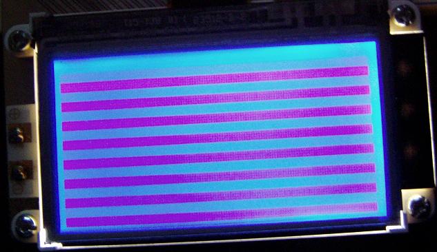

    Thanks for all the replies.
    I still have to control individual characters, contrast and the touch screen, but I got it to work. I printed xF0 across the entire LCD, to make it easy to see output. I have the LCD on inverse in this example, the top of the line should be high, not the bottom.
