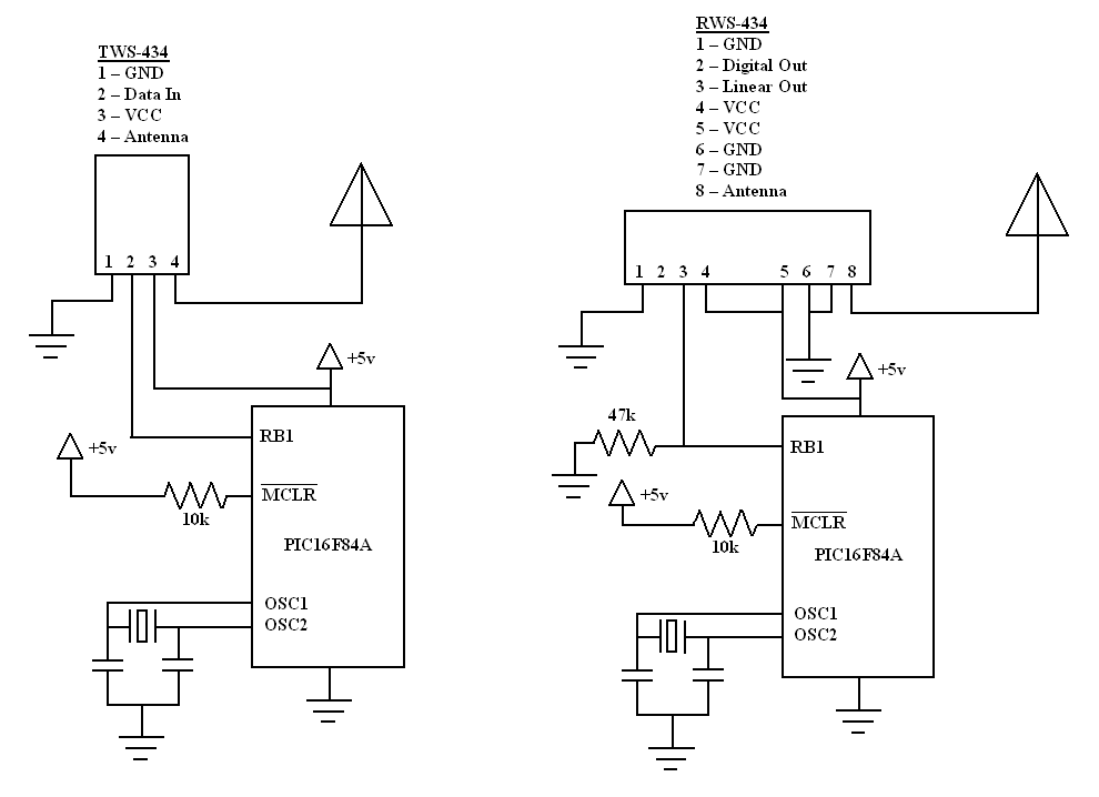

    could somebody post a schematic for connecting a tws/rws-434 to a Pc connected pic to talk to a tws/rws434 remote pic

    I have attached a schematic of how I connected tws/rws434 modules to pics for pic-pic rf communication.
    I used serout2 and serin2 in pbp to transmit and recieve:
    Transmitter
    SEROUT2 PORTB.1,17197,[$55,$55,$66,data_out]
    Reciever
    SERIN2 PORTB.1,17197,[wait ($66),data_in]
    Kamikaze47, Why are you using the linear output instead of the digital output? I would think the onboard comparator in the receiver would be a better bet at getting a "Clean" waveform.
    Perth, Australia
    429
    Not sure why, but I seemed to get better range with the linear output. Cant explain it.
    Jul 2005
    93
    I can only seem to use the linear output
    thx for the post.. i'll put what i have setup soon... my setup matches your schematic....
