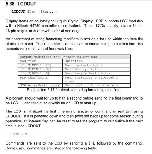

    I should have first, but I totally forgot to give a look to the PBP manual:
    Name:  2026-03-15 15_54_15-2026-03-15 15_52_42-PICBasicPro_Compiler-Manual_2013.pdf - [PICBASIC PRO™ Co.jpg
    May I ask what the semicolon at the end of the LCDOUT command does? I tried with and without and can't see the difference.
