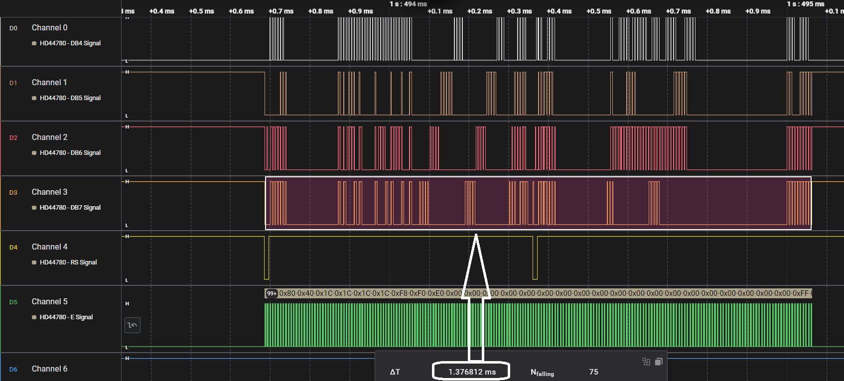

the displays are very fast, pbp has no trouble uploading a full 200 byte frame to the display in 1.37mS using 4bit parallel interface with the standard built-in lcd routines
plenty fast enough
