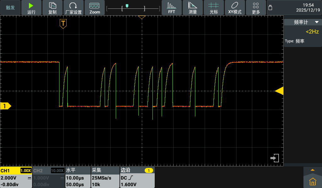

I decided to check the signals with scope, and they're heavily distorted. (image 1) I have 10K pull-up resistors on both SDA and SCL pin. So to test the issues, I've added this simple code:

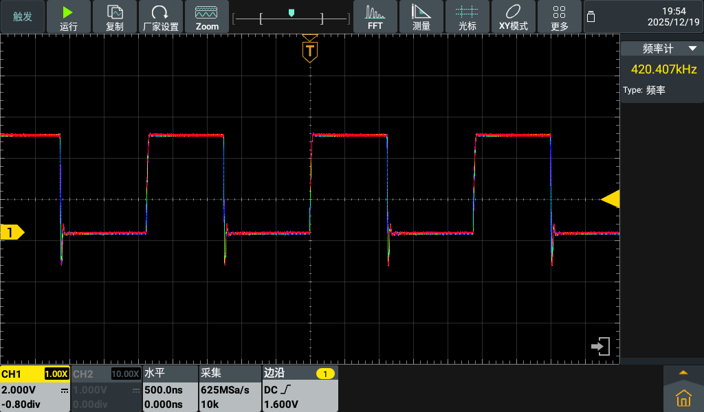

asda: 'small test for waveform shape
high SDA_PIN
pauseus 1
low SDA_PIN
pauseus 1
goto asda
When I run this code, the shape of the signal is perfect, as you can see from the 2nd image (and frequency is much higher, so definitely no capacitive loading issues). So what can be the reason I2CWRITE making so badly shaped signal?
