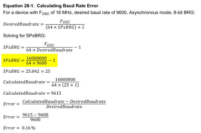

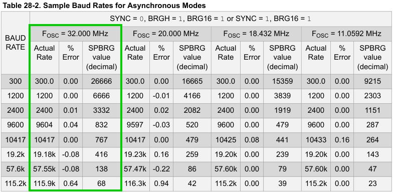

    its probably better to say
    there are two baudrate clock source dividers brgh=0 ; fosc/64 and brgh=1 ; fosc/16 and
    and you have the choice of 8 or 16 bit baud rate generators, so 4 options for every baud rate
    BAUDCON.3 = 1 'Enable 16 bit baudrate generator
    brgh=1
    for 19200
    SP1BRGL = 160:SP1BRGH = 1
    for 9600
    SP1BRGL = 64:SP1BRGH = 3
    brgh=0
    for 19200
    SP1BRGL = 103:SP1BRGH =0
    for 9600
    SP1BRGL = 207:SP1BRGH = 0
    BAUDCON.3 = 0 '8 bit baudrate generator
    brgh=1
    for 9600
    SP1BRG = 207
    for 19200
    SP1BRG = 103
    brgh=0
    for 9600
    SP1BRG = 51
    for 19200
    SP1BRG = 25

    Still a question: why would one choose the 8 bit baudrate generator - seems less accurate, no?
    Roger
    2,722
    Default Re: 16F18446 - setting baudrate for HW EUSART
    in reality accuracy is not always critically important, 1% or larger errors still work well in 90% of cases for tty serial transmission.
    8bit generator results can be equally accurate anyway.
    if you want to switch between rates rapidly a 8bit change is twice as quick to implement as a 16 bit one
