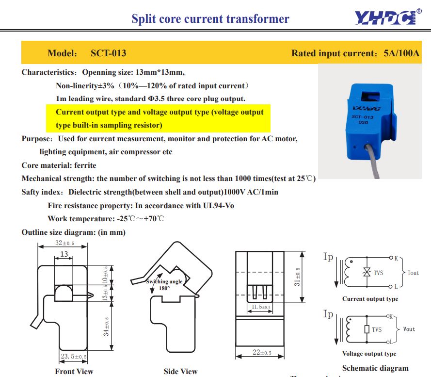

    SWITZERLAND (french speaking)
    952
    Default YHDC current sensor - the theory please
    you cannot use a current transformer that way without a burden resistor
    Does this mean there is no resistance inside the sensor?
    Roger
    2,705
    Default Re: YHDC current sensor - the theory please
    can't tell, the picture is too blurry to read properly but i see no reference to a resistor mentioned it the bits i can read
    post a link to data sheet
    edit
    ps, found this so no resistance inside the sensor
    Name:  Screenshot 2025-12-08 202039.png

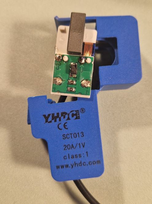

    ...and from the same supplier:
    Saint Thomas taps me on my shoulder!
    Name:  Inside V YHDC small.jpg
    In the 20A/1V model, there are two resistors and a TVS diode. The first resistor is 1k2 and the second is 1k.
    I also checked a 100A:50mA model and there are no resistors in there, only a TVS diode.
