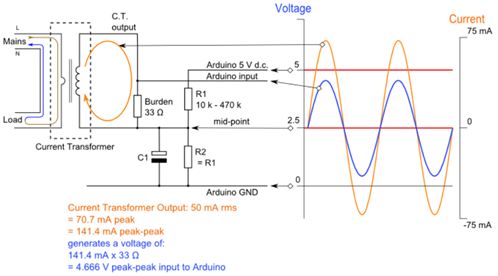

    For now, I have a 16F18446 carrying a 12 bits ADC that I hope sufficient just to put me on the track and avoid the usage of an external higher resolution ADC chip adding "difficulties".
    The YHDC sensor I have on my bench is a 100A:50mA model.
    I found a lot of these drawings like this one below but I can't make them work or better said, I don't know how to "read" their output.
    Do I have to sample let's say a 30 to 50 times or so to grab an alternance, find out both zero-crossing values (or as close as possible) and then extract the higher value in between?
    What is the correct way to do this?
    Thanks for any explanation on this one

    If you are trying to read the magnitude of current flowing in the primary of the current transformer(CT), you would like to first amplify the AC output of CT using an op-amp. Then do a DC peak conversion on the output of the op-amp. Read this value. It will be proportional to the current flowing in the primary. The ADC on the PIC can now read this DC value in a poll.

    It can't work wired the way you described. The ac signal must be biased by vcc/2 and be less than vcc peak to peak.
    If the serial baud rate is too low it will ruin the sample rate.
    If the burden resistance is incorrect extremely high voltage may be possible
    Post code and schematic
    Default Re: YHDC current sensor - the theory please
    Have you connected your CT as shown in your first post? That is, the bottom to 2.5V (or VRef/2) and the top to input pin AND - VERY IMPORTANT - a load resistor shown as 33ohms in diagram? You must have a load resistor or the output voltage across the secondary of the CT can get very high, possibly damaging the ADC input.
    Then, your CT produces 50mA with a 100A primary current. 1A primary give 0.5mA and so yout 42W load gives about 100uA secondary current. Keep that in mind when selecting the load resistor.
    EDIT: OK, Richard beat me to it while I was typing.

    sample wave, note peaks and mid point values

    Oh, I get it now, the "plotter".
    I just need to monitor a current level that will trigger a relay.
    I do have ACS712 but the problem is, the current has to pass inside (though) the component meaning I would need to modify the cabling inside an electric board where it is intended to be installed. But I want to avoid this - it has to be like SHELLY energy counters or so.
    I just received a module, an analog AC Current Sensor SEN0211 unsing a YHDC current transformer: DFROBOT. I'll give it a try.

    you cannot use a current transformer that way without a burden resistor
    Does this mean there is no resistance inside the sensor?
    Roger
    can't tell, the picture is too blurry to read properly but i see no reference to a resistor mentioned it the bits i can read
    post a link to data sheet
    edit
    ps, found this so no resistance inside the sensor
    Name:  Screenshot 2025-12-08 202039.png
    Again as always: R T Full M

    ...and from the same supplier:
    Saint Thomas taps me on my shoulder!
    Name:  Inside V YHDC small.jpg
    In the 20A/1V model, there are two resistors and a TVS diode. The first resistor is 1k2 and the second is 1k.
    I also checked a 100A:50mA model and there are no resistors in there, only a TVS diode.
