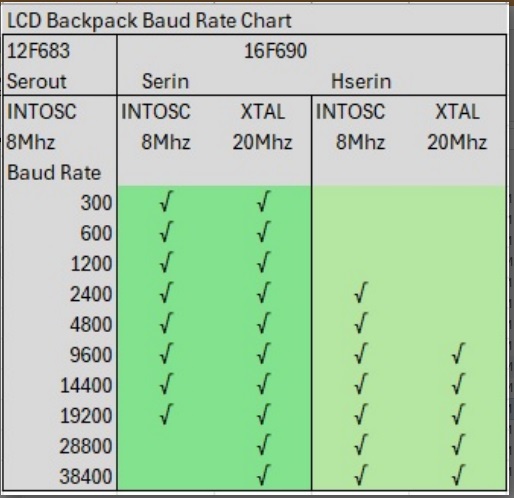

update on 16F690 Backpack, new LCDINT pause to accomodate 28800,38400 baud rate for (Xtal = 20Mhz)
__config _HS_OSC & _WDT_OFF & _PWRTE_OFF & _MCLRE_OFF & _CP_OFF & _CPD_OFF & _BOD_OFF & _IESO_OFF & _FCMEN_OFF
LCDINIT: ' Standard LCD Module Initialisation
PORTC = %00000001 : HIGH EN : PAUSEus 1 : LOW EN : pause 4 ' Clear Display
PORTC = %00000010 : HIGH EN : PAUSEus 1 : LOW EN : pause 2 ' Return Home
PORTC = %00111000 : HIGH EN : PAUSEus 1 : LOW EN : Pause 2 ' 8 bit, 2 line, 5x8 Characters
PORTC = %00000110 : HIGH EN : PAUSEus 1 : LOW EN : Pause 2 ' Entry mode
PORTC = %00001110 : HIGH EN : PAUSEus 1 : LOW EN : Pause 2 ' %00001DCB Display on/off, Cursor on/off, Blink y/n
