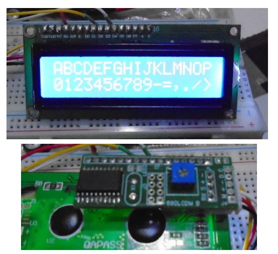

Hello everyone,

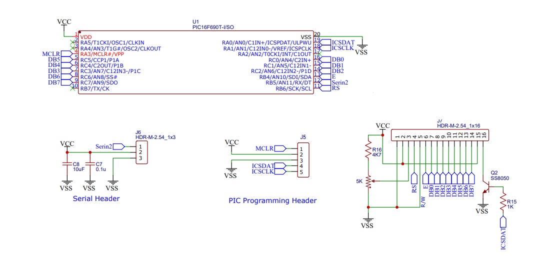

I'de like to share this project, may come handy for hobbyist working around LCD display.
My search for a serial LCD that can receive serial data from 300 to 19200 baud on the internet was not successful
then I roll-up my sleeves and build this LCD backpack that use a common Hitachi HD44780 display. (still popular today)
My project was simple with parts already on hand like PIC16F690, NPN smd transistor, potentiometer, resistor. and PBP3 Basic code.
So enjoy,
