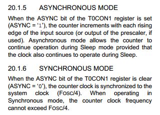

    Default Re: K42 and Timer Interrupts
    The SYNC block uses FOSC/4 as its sync clock, so it's difficult to use it if it's using FOSC/4 as its input source for counting too.
    for 16-bit read/write see sec 20.1.1.1:
    In 16-bit mode the operations should be: write TMR0H, TMR0L and read TMR0L, TMR0H
