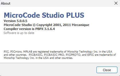

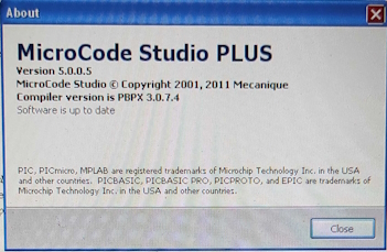

    Thanks to everyone for the help and I update the post:
    I finally managed to repair Windows XP, blocked since 2016, containing PBP (PBPX 3.0. 7.4) and MicroCode Studio (MCS+ 5.0. 0.5), which now work perfectly.
    Now I intend to install the entire environment (PBP, MCS, MPLAB) on the Notebook with Win 11 pro.
    The internet functions work (tracert and ping), but of course Win XP does not allow navigation.
    What is now the procedure to recover the license installed on XP?
    Do I simply have to uninstall the 2 applications with the internet connected?
    3,624
    Default Re: Starting with PBP: how to restart with PBP today

    Mar 2012
    13
    what do get out of mcsp thats of any value over plain mcs , the code level debugger is a joke and basically useless
    After the MCSP installation error, I am stuck with MicroCode Studio version 5.0.0.5
    If it is not essential to use the Plus version, I will follow your advice.

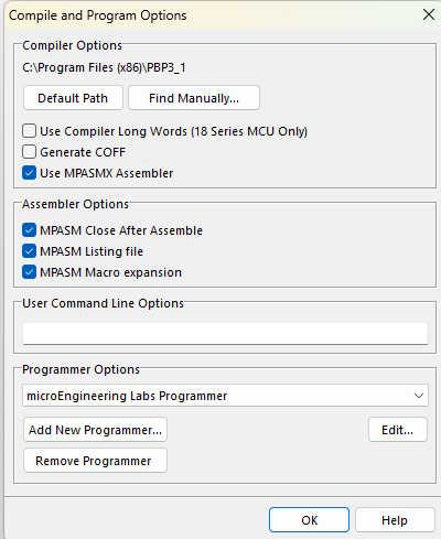

    I have installed MPLAB X IDE v5.35
    And I have the configuration
    Name:  Compile and Program Options.jpg
    Can I start playing?
    Thanks to everyone for the valuable advice.
    3,624
    Yeah, that sort of policy sucks. I don't mind paying for good stuff but I don't like having to pay for the same thing more than once. And don't get me started on subscription licenses...
    I've bought MCSP twice, it will not be a third time.
    Looks like you're good to go!
