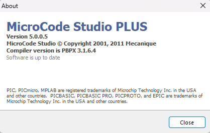

    Name:  About MCS e BP.jpg
    Thanks to everyone for the help and I update the post:
    I finally managed to repair Windows XP, blocked since 2016, containing PBP (PBPX 3.0. 7.4) and MicroCode Studio (MCS+ 5.0. 0.5), which now work perfectly.
    Now I intend to install the entire environment (PBP, MCS, MPLAB) on the Notebook with Win 11 pro.
    The internet functions work (tracert and ping), but of course Win XP does not allow navigation.
    What is now the procedure to recover the license installed on XP?
    Do I simply have to uninstall the 2 applications with the internet connected?

    After the MCSP installation error, I am stuck with MicroCode Studio version 5.0.0.5
    If it is not essential to use the Plus version, I will follow your advice.

    Quote Originally Posted by CipOne View Post
    Attachment 9962
    Update for future group members who have my problems:
    I managed to install my MCSP license, changing the Win 11 system date to the license period, with an active internet connection
    Hope it stays working...
    Thanks for the tip ...
