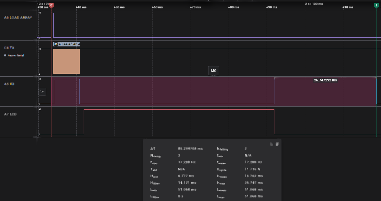

    I know it's transmitted properly using Saleae probe:
    Name:  Missing HSEROUT v3.png
    The data is complete on top row (RX from TX PIC), but missing on bottom (TX towards PC).

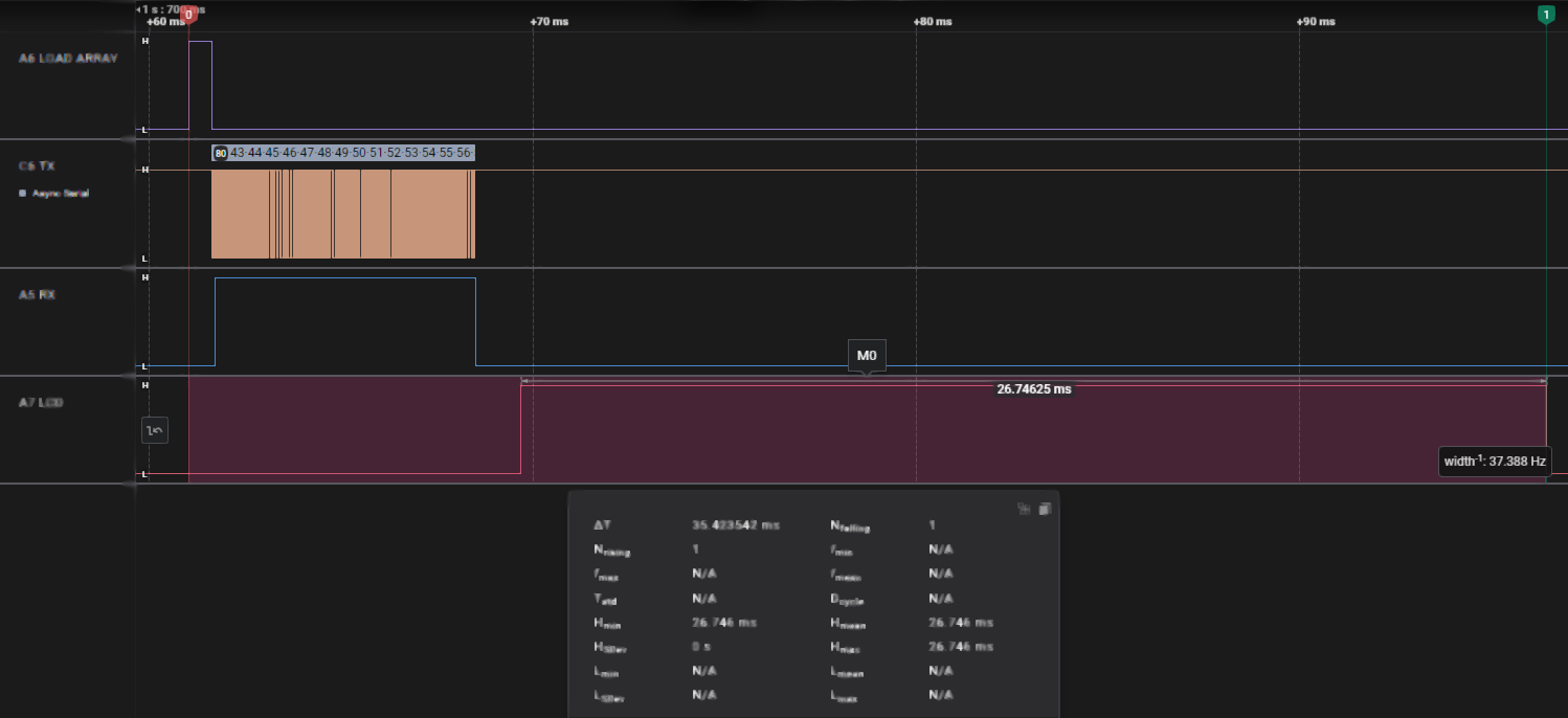

    Default Re: Losing data when extracting bytes from words
    This is when I run it up to 1990, and repeat the 90 series at the bottom; always the same numbers are messed up.
    Missing HSEROUT v4.pdf
    I just noticed something. It didn't wait for the 90 series to complete.
    Something is not always working with my OK reply.
    Name:  Missing HSEROUT v4.png
    EDIT: Confirmed, I checked the longest saved SALEAE session. All the series that are chopped are missing numbers that relate with how early the TX started on the RX PIC. It didn't wait for the HSERIN to complete, and took off running.
    I can't explain why it's always the same series.
    Something tells me the DEFINES are different for this PIC, and I blindly copied over existing code.

    I turned the pot pretty fast and this is the fastest interval I got from start of 1st TX to start of 2nd TX:
    Name:  Fastest pot movement.png
    I'm still studying your TX/RX module. At least now I have a control that I can compare with.

    To make sure I wasn't losing data, I returned the data I received. I also used the 45mm slide pot for another speed test; zipping that sucker as fast as I could: 1.234 mSec from start to start of TX.
    These are the signals, in case the text from Saleae probe is not clear enough (they get a little fudgy or some reason):
    Primary PIC:
    - TX
    Secondary PIC:
    - RX-INT
    - LCDout ADC values
    - TX confirmation
    - LCDout "X" indicator (this is for testing only, to see if other pots "jitter")
    Note that data is not lost even if bottom LCDout overlaps into next message.

    I figure I'd push the envelope a bit faster with that 45mm slide pot; 1.228 mSec from start to start of TX.
    I also took out that 2nd LCDout with the "x" indicator, it was just for testing anyways.
    This time I went faster than the previous ADC increment changes of 3, I managed to go to 7 and still no data lost:
    Name:  Fastest pot movement v3.png

    I'm testing that right now; 1 program with aliases, 1 program with strcpy:
    - TX 80 character (same TX program for both tests),
    - RX 80 characters and display 80 characters (I fill up a 4x20 LCD with text),
    - compare the time on Saleae.
    Default Re: Losing data when extracting bytes from words - 16F18855
    Very convenient indeed!
    Yup, now confirmed. It's faster to use aliases than Richard's module strcpy.

    Saleae probe timings from before Load Array in TX to after Lcdout in RX
    TX/RX using aliases, 35.4 mSec:
    Name:  Load alias v4.png
    TX/RX using strcpy, now 85.2 mSec, adds 50.0 mSec step during strcpy:
    Name:  Load strcpy v4.png
