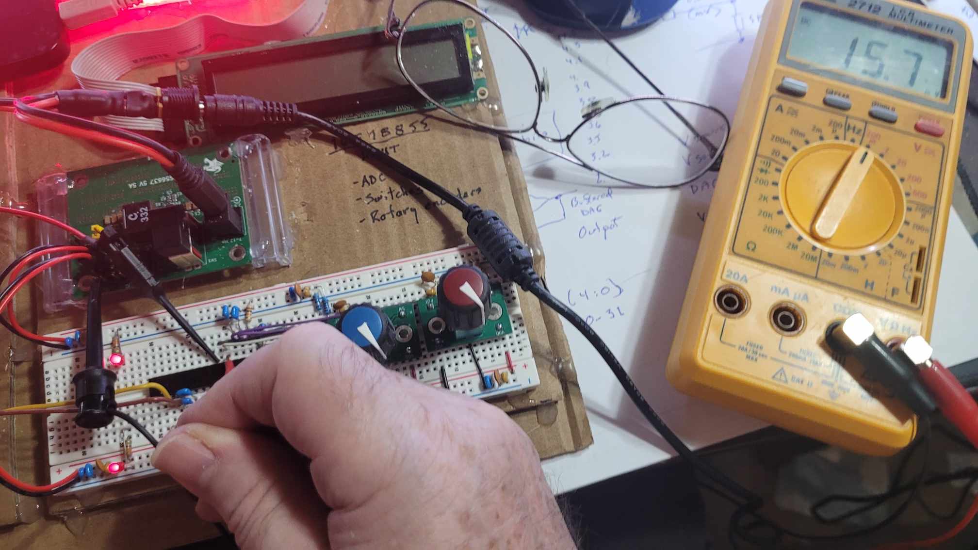

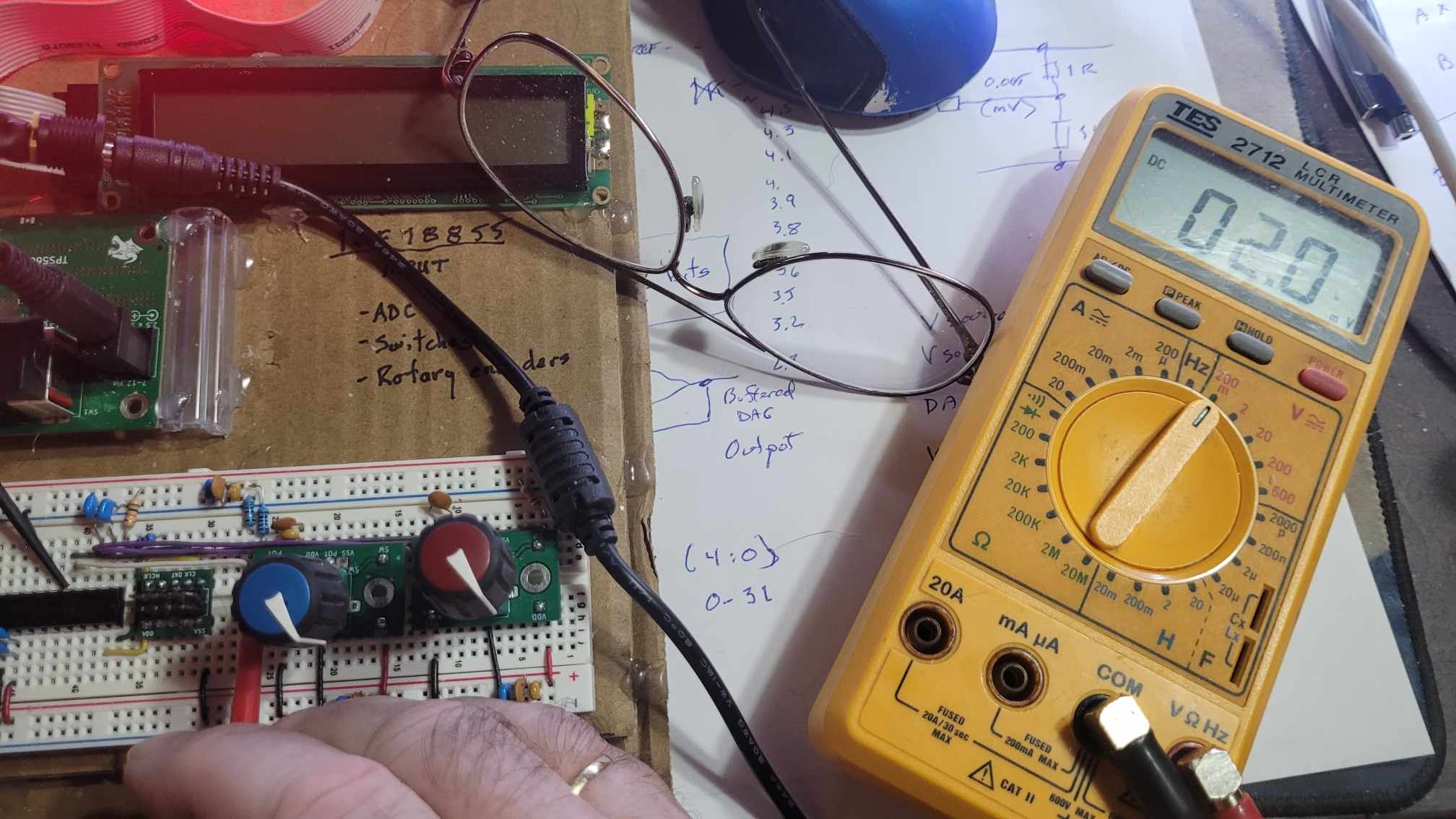

    I set at 200ohm on multimeter to get more accurate reading:
    left pin to wiper = 2.5R
    right pin to wiper = 2.6R
    left to right = 4K7
    It doesn't go all the way down to 0, or up to 5K.
    ADC readings for this pot are 2 - 254 (I had removed 2 bottom bits).
    EDIT: I was using 20K setting for all readings before.
    Default Re: Using VREF pins for pots that don't reach ADC=0 or 255
    I went back and did same readings at 200 ohms on the other pot that had ADC from 0 - 255:
    right pin to wiper = 1.9R
    left to right = 5.05K (at 20K ohms)

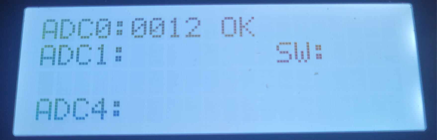

    16F18855 with 5K pot
    So I have 2 rotary pots that refuse to go down to ADC=0. So I thought it was a perfect occasion to practice using Vref-.
    I've gutted my code so there's only 1 pot being scanned:

    The pot has a reading of 2.0mV when full right:

    The Vref- pin reads at 15.7mV (used voltage divider 1K (0.985R really) / 3R:

    Pot 0 does not go below ADC=12,and is transmitted on the Saleae probe:

    And shows up nicely on LCD on 2nd PIC:

    I don't get it. I thought setting Vref- at 15.7mV meant that anything reading below that would read as 0...? I thought I was essentially raising the VSS lower range for ADC.
    ADREF = %00010000                   ' ADC REFERENCE SELECTION REGISTER
    '   bit 4 ADNREF: ADC Negative Voltage Reference Selection bit
    '               1 = VREF- is connected to VREF- pin
    '               0 = VREF- is connected to AVSS
    I'm obviously missing something stupid again, but I don't see what. Or I totally misunderstood what Vref- does in life.
    each adc step is 4.88mV therefore it should read zero
    you get a reading of 12 , after un-dividing by 4 that's a count of 48 or 0.234 volts
    it virtually has to be power supply noise.
    no amount of dicking around with reference voltage's is going to eliminate that much noise
    eliminate your power supply as the culprit by using 3x fresh AA batteries in its place
