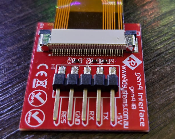

    Dear all its being long time since my last post. I had so many things lately. Just realised that i had a small project that i havent completed.
    Not this is almost done and working up to now.
    Take your time to check it out if you have a PixxiLCD25P4CT together with a PIC18F26K22.

    im using Visi Genie for this particular setup. No other coding in 4D Systems's platoform.
    Also im using the PIC18F265K22 at 5V. I do not use any resistor in betten as the circuit board is coming with the 4D Systems display has the resistors in on board.
    Name:  Screenshot 2025-02-23 000710.png
    I will also try to impove the code as i just found a small bug. (not really a bug but just needs a fine tune)
