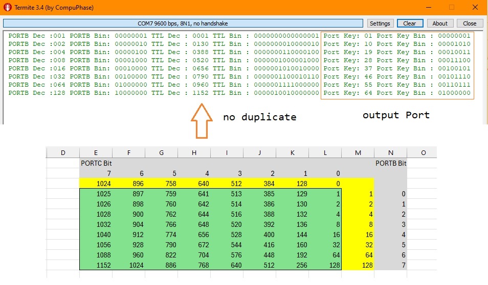

    Hello everyone,
    I'm looking for some tips, to enhance the code listed here to simplify with less code the "Select case'.
    This code is for a PIC18F25K22 using PortC as a 64 switches matrix scan and PortB as the receiver and decoder and PortA to send the data.
    Thanks for any comments.

    Attachment 0
    Name:  keypad value rpt.jpg
    Attachment 0
    Name:  64 keys circuit diagram.jpg

    2,721
    Default Re: Select case function
    for a 8x8 keypad there are 64 possible results
    that's an extraordinary convoluted way to get a result
    why not
    key var byte    ; high nibble column  low nibble row
      if portb then    'look for a 1
          key = ncd portb  'row    look for a 1
          key = key + (ncd portc )<<4
          PORTA.1 = 1  ' Data Available
          WHILE PORTB >0 :wend
    Jan 2022
    78
    Thank you richard
    the reason I had to add a value to the portc, was the fact in the 64 key matrix some code were duplicate.
    so 2 different key had the same value.
    I'll have to test this code.

    Hello Richard
    by inverting portb / portc I found no duplicate
    If I may ask, how to know the time it took from the start to end of a for/next loop or select case in a program
    Many thanks for your support.

    Default Re: Select case function Last update (Benchmark : PortKey 1~64: 3.988us ~ 6.25us)
    This is the lasted update, some changes the 'Select case' as been move down
    this alone is reducing the response time from 11us to 6us to the data available.
    While the propagation time at the D/A of the MM74C922 is 60ns ~ 150ns max.
    It will be hard to even get close to 500ns with the PIC18F25K22 unless someone has an idea to share.
    I searched the internet for an affordable / alternative solution is to get into the CPLD or FPGA but it's not cost effective + VHDL learning process.
    Any constructive comments is welcome.
    Name:  Key Sheet.jpg
