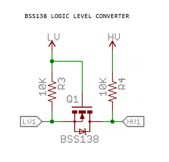

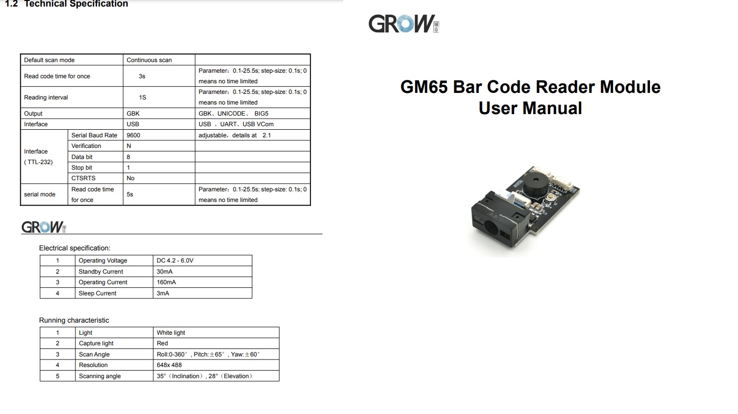

    Hello everyone, and thank to all for helping me
    this case is solved!
    1st
    the GM65 scanner Tx/Rx line are at 3.3v not at standard 5V TTL logic, so I add a BSS138 between the Tx and the Rx (HSerin) of the PIC
    2nd

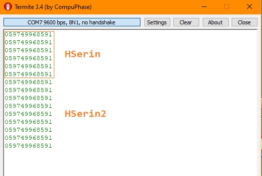

    I like to thank also BrianS (HSERIN issue with a 18F452 and IF THEN statements or Case statements)
    while reading about his case I took part of the HSerin setup and added to my program, first try work just fine on HSerin/HSerin2.
    ' Name : Hserin Test  (18F25K22)
     Include "modedefs.bas" ' Include serial modes
    ;----[18F25K22 Hardware Configuration]------------------------------------------
      CONFIG  FOSC = INTIO67
      CONFIG  PLLCFG = ON
      CONFIG  WDTEN = Off
      CONFIG  MCLRE = INTMCLR
      CONFIG  LVP = Off
    DEFINE HSER_CLROERR 1
    DEFINE HSER_BAUD 9600
    RCSTA = $90
    TXSTA = $20
    DEFINE HSER2_CLROERR 1
    DEFINE HSER2_BAUD 9600
    RCSTA2 = $90
    TXSTA2 = $20
       ANSELA = 0  ; All Digital
       ANSELB = 0
       ANSELC = 0
    DEFINE OSC 64
    TRISA = 111101    '1:IN, 0:OUT
    TRISB = 000001
    TRISC = 111101
    OSCCON = $70
    OSCTUNE = $40
    AArray VAR BYTE[12]
    ' code to scan sample : 0 59749 96859 1
    MAIN:
    HSERIN 50,MAIN,[STR AARRAY\12]
    'HSERIN2 50,MAIN,[STR AARRAY\12]
    serOut2 PORTB.1,84, [str aarray\12,13,10]
    GoTo MAIN

    2,722
    Default Re: 18f25k22 hserin
    No code error , no compiler deficiency. as suggested in post #9 its wired incorrectly
    who would have known
    Jan 2022
    78
    Specialy when the GM65 user manual mention TTL logic level, yes the DC supply is 5V, for the USB / UART ports.
    but it's not specify 3.3V Tx/Rx output line.
    Learning everyday like everyone here.
