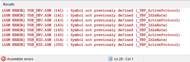

    What is "Include "descript.bas"?
    4,170
    Default Re: PIC18F14K50 USB Not Working
    maybe he meant
    Include "hid_desc.bas" ?
    Miami, Florida USA
    704
    maybe he meant
    Hmm, it works with the "hid_desc.bas" include. The descript.bas file is part of a HidMaker package that I bought before. Apparently, this descript file was made only for the 18F4550. Unfortunately, HidMaker went out of business. His owner Dr. Bob is not even responding to the emails. It is a shame to see a great program like HidMaker to close.

    Maybe the syntax of the descript file is different than the one expected?
