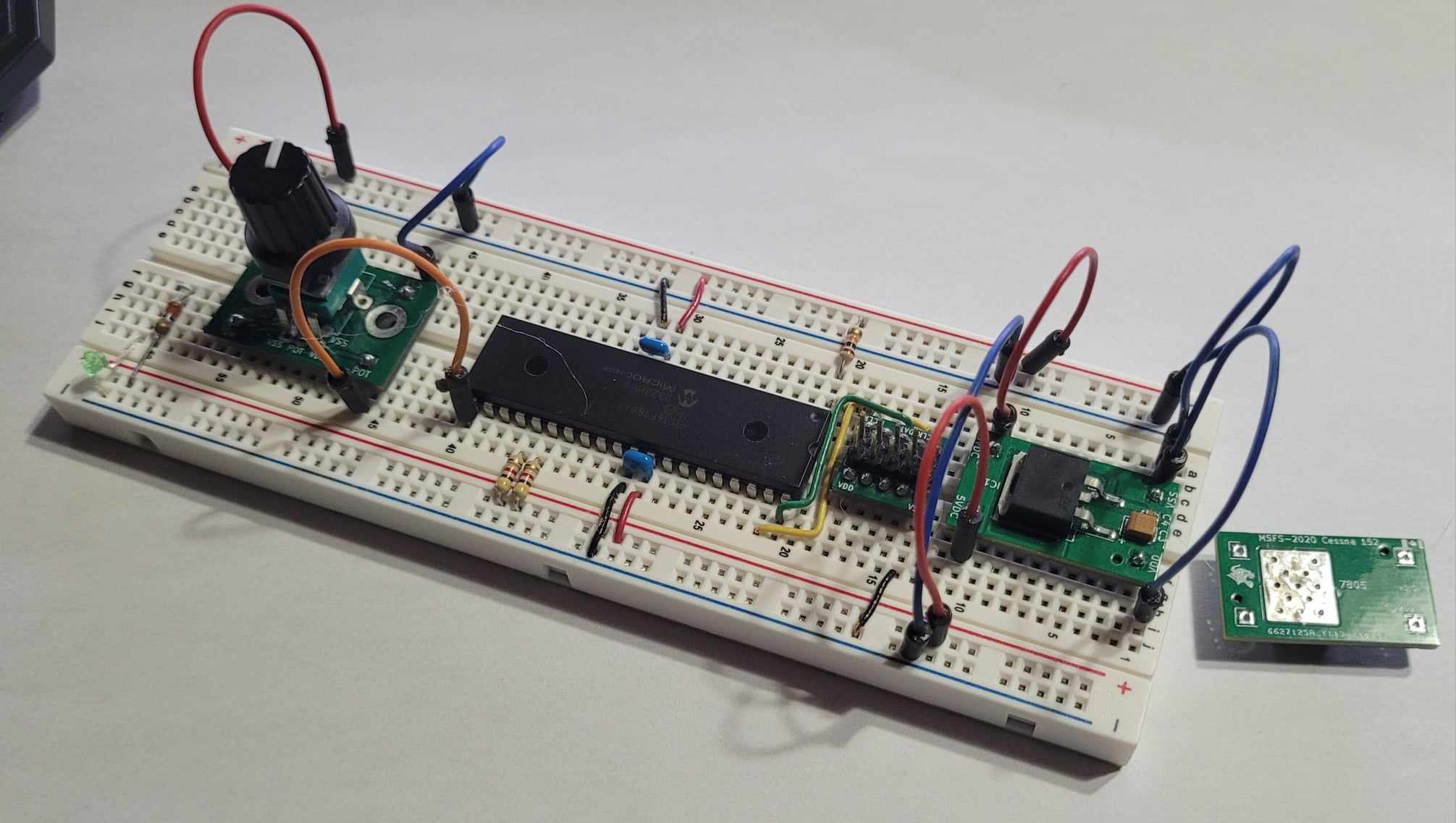

    I made a 7805 circuit for testing, but it's only rated for 1.5A.
    I wish I had seen the LM1084 before; it can handle 5V up to 5A, more than enough for my design. At least it's a piece of cake wiring a through-hole LM1084 with some caps instead of the DC-DC converter.
    Just be aware that if you're starting with 12V VIN then the regulator is going to dissipate roughly 5W with 700mA out (from your other thread).
    Pd = (12V-5V) x 0.7 = 4.9W
    That's going to get quite hot... over 100degC rise depending on the package type.

    I had 2 options originally:
    - stay under 500mA and use USB power
    - use a wall adapter and add a voltage regulator component.
    USB power is no longer an option with the 4 LCDs. I don't have any "simple" design for a SMPS that would have noisy power.
    The LM1084 "should" be as clean as the 7805 (I hope).
    I can use the TO-220 package with cooling fins, and even add a tiny cooling fan. Tests will confirm how much heat I will generate with everything.

    Received the LM1084-ADJ, still waiting on the recommended caps (to properly test ripples), but it's already running nicely with what I have on hand.
    Also got a thermal imager to help identify hotspots. Looks like I fried 2 PICs with those 12V and 7V bursts (lesson learned).
    LM1084-5V on right, supplies PICs, ICs and LCDs, essentially everything that is "always ON", with a slight tweak on ADJ pin to get it slightly above 5V to compensate for voltage drop.
    LM1084-ADJ on left, supplies LED strips, cooling fans (to be determined) and anything else that doesn't care about ripples.
    (HIKmicro E02)
    Name:  Dual VR thermal.jpeg
    Name:  Dual VR normal.jpeg
    No thermal compound yet, this was a temporary setup to help prevent forest fires.
    Name:  Dual VR prototype.jpg
    I'm sure there's better ways to skin a cat, but this was the simplest technique I could come up with. It remains to be seen if the ripples are "manageable" for the ADC on the PIC circuit.
