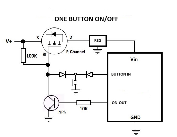

    Default Re: Complete circuit RESET
    I like this idea
    Name:  highside pwr sw.jpeg
    Thumbs down Re: Complete circuit RESET
    Where would a load go on this circuit (LCDs and other PICs)?
    2,692
    Anywhere off the mosfet drain or the regulator, it's just a switch
