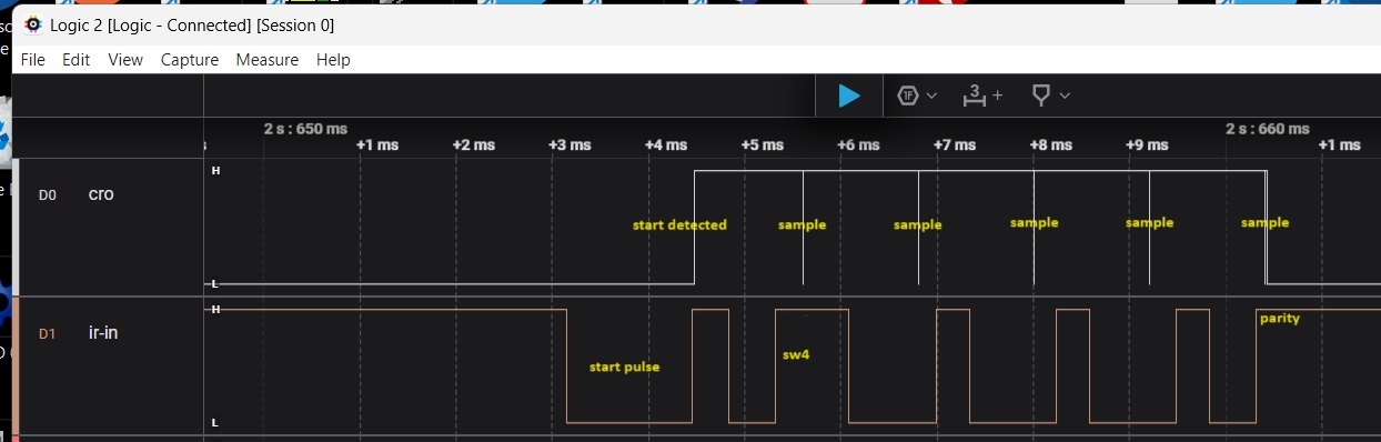

    Default Re: IOC on negative edge sometimes triggers twice on single press
    I'm not sure what I'm looking at in the video but inadequate debounce on the input would be my number one guess....
    The graphs show the signal at the switch and PIC pins; to confirm the absence of bounce on the signal.
    The LCD in the foreground shows the frequencies being swapped back and forth.
    ... I believe DT_Ints resets the interrupt request flag on exit of ISR (@ INT_RETURN)...
    - I changed checking IOCBF.2 to checking Port pin; no change, random double-processing.
    - I changed clearing IOCBF.2 = 0 to IOCBF = %00000000; no change, random double-processing.
    see the white negative going spikes that indicate when samples are taken by my routine,
    the spikes are 1 uS in width , on my rigol 100MHz 1Gs/S oscilloscope @ 0.5mS/div they are not accurately rendered nether are all that are in scope always even visible . saleae to the rescue at max res.
    digital tools need to be understood and taken with a pinch of salt
    i should point out @100uS/div all are visible but the display window is too small to see what i was looking for
