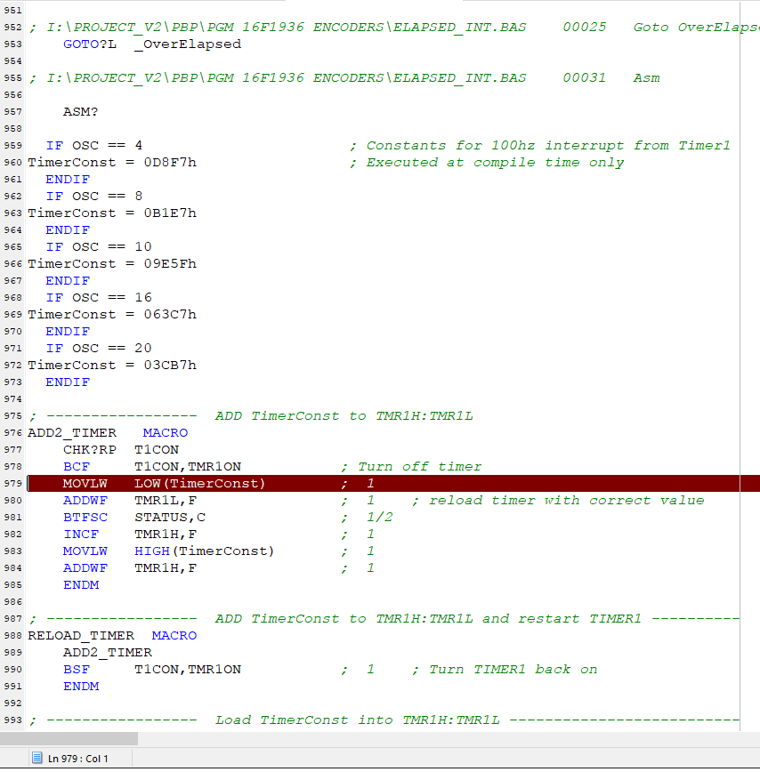

    I even made sure to put the INCLUDES in the exact same order, but the error persists.
    Name:  Elapsed timer issue.png
    It's either something totally obvious, or painfully obscure.
    I can see the future! It turns out it's a combination of totally obvious and painfully obscure. It was looking at me right in the face.
    I added in Elapsed_INT.bas and it compiled without TimerConst errors.
      If OSC == 32
    TimerConst = 0FFB7h
      EndIF
