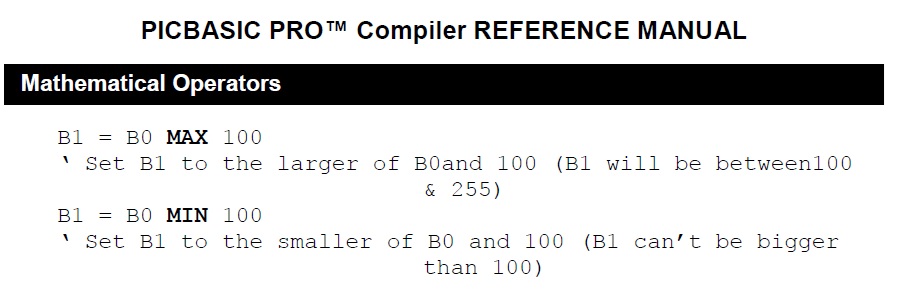

    pbp has a max and a min commands
    by combining max and min you can constrain a variable to a
    range of values

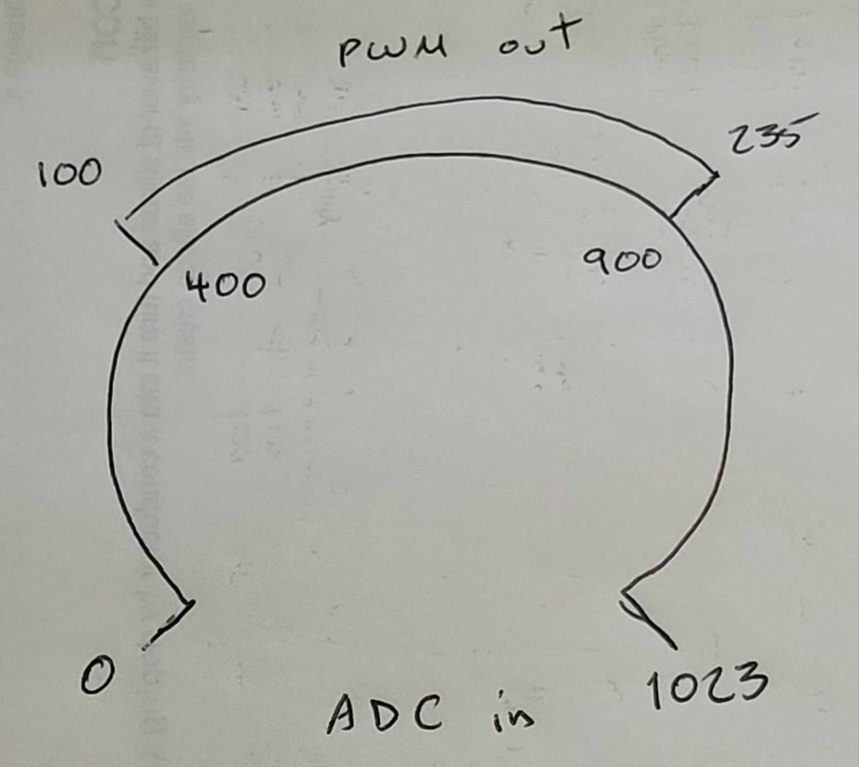

    I just realized I didn't express myself properly.
    As I turn the pot, the formula should convert from 0 all the way to 1023, to a new range of 100 to 235.
    Or else I have that dead spot under 400 and above 900.

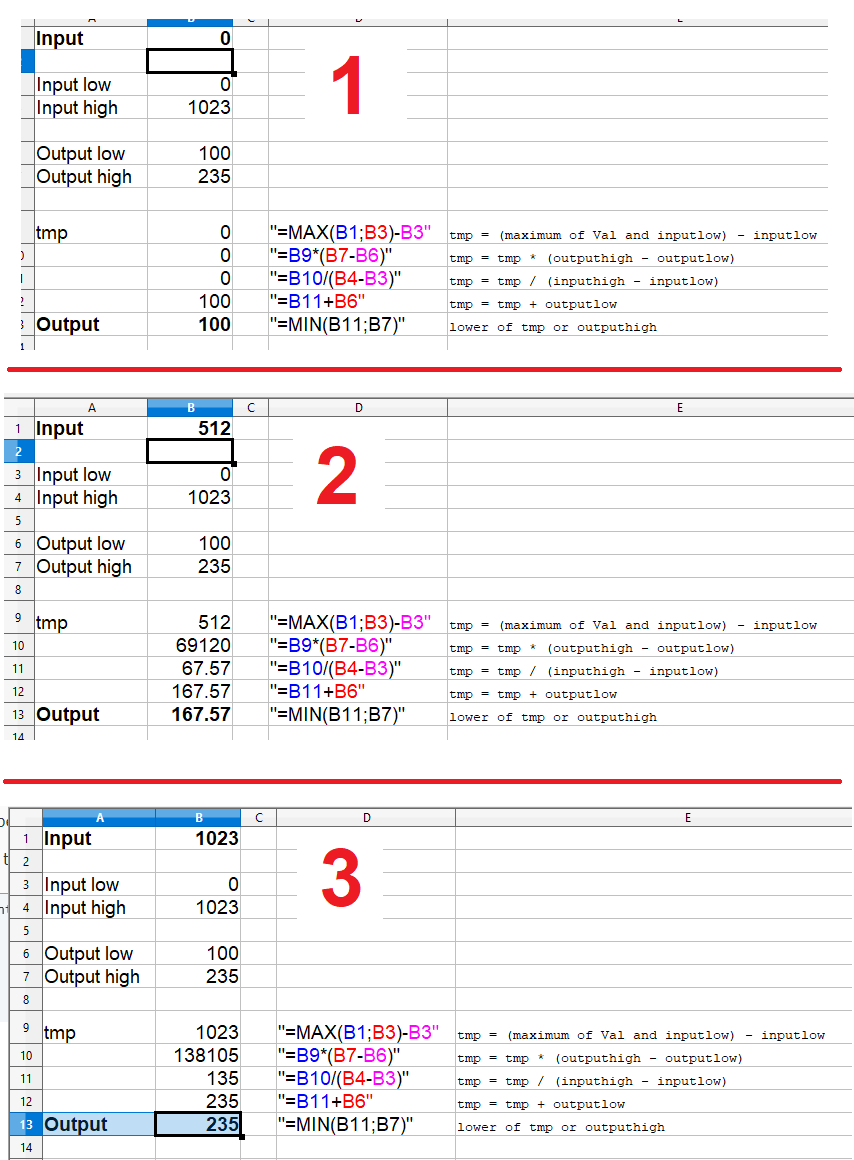

    Freaking awesome!

    P.S. Test it in Excel and I think there is a mistake on the B3 function. My output result on B13 is always equal to B11.

    There is a mistake on B13, it should be MIN(B12;B7)
    Good eye.
    I had corrected the formula in B13, but had somehow missed the text in C13 (it's just text to show what goes on in the real cells in B column).
