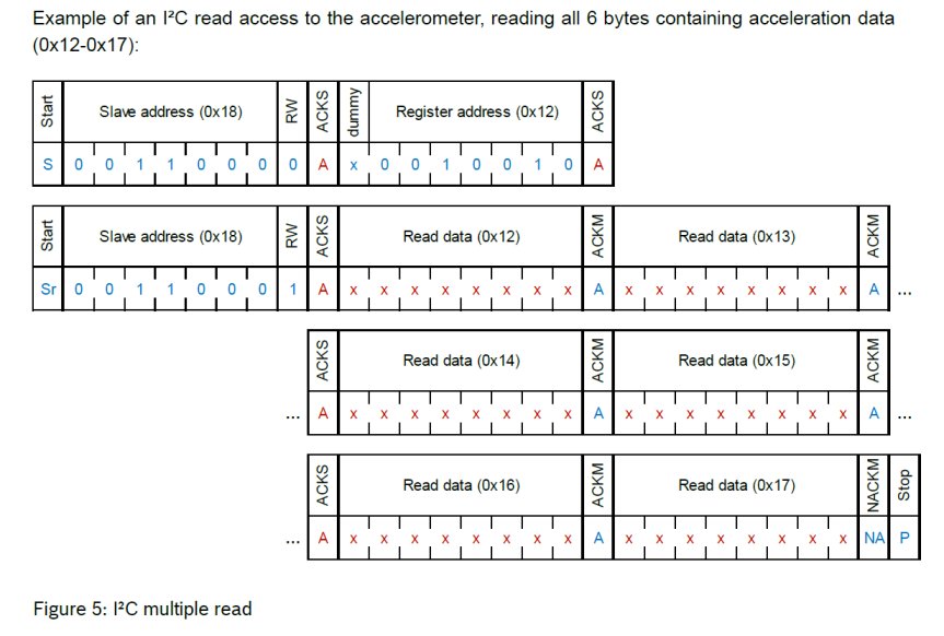

    Has anyone played around with the BMI088 IMU? Or possibly a similar IMU from Bosch? I'm having trouble getting valid data using I2C from it. I've run some code to read the registers from both the accelerometer (address=$18) and the gyro (address=$68), but get back $20 (dec 32) for all registers.
    I have it configured for I2C with the following pins:
    Pin 5 (CSB2) - NC
    Pin 7 (PS) - VDD
    Pin 10 (SD02) - GND
    Pin 14 (CSB1) - VDD
    Pin 15 (SD01) - GND
    Section 6.2 of the datasheet (under the "I2C Read Access" heading at the bottom of page 50) along with figure 5 seems to indicate I need to perform an I2C write command to the relevant address to specify the starting register, then perform an I2C read command to the same address without specifying a register to get the data. Is my interpretation of this correct? I have posted Figure 5 for convenience below:

    I think accelerometer is at address $30.

    I don't think that's correct. In the picture of figure 5 that I attached in my post, it shows the accelerometer address as "0x18". Also page 61 of the datasheet states:
    The default I2C addresses are:
    > Accelerometer:
    SD01 pin pulled to 'GND': 0011000b (0x018)
    SD01 pin pulled to 'VDDIO': 0011001b (0x019)
    > Gyroscope:
    SD02 pin pulled to 'GND': 1101000b (0x068)
    SD02 pin pulled to 'VDDIO': 1101001b (0x069)
    Is there a reason you think it is $30?

    Ah, yes, you think it should be $30 because I'm an idiot and it should be $30. :-) I always consolidate the R/W bit in the address and forget about it until the next new sensor I try to interface and have to remember it all over again. There's a small chance that one day I'll learn.
    Thanks!
