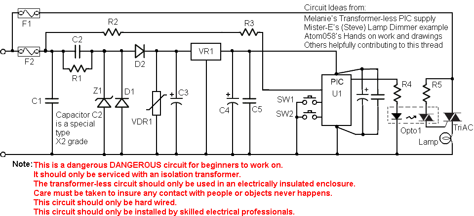

    Here is the artwork, BOM and code for the new-and-improved AC Lamp Dimmer. Everything you need to make one. There is only one issue that I have with this but it is not important for my use, but maybe someone else can shed some light (!) on it. When going from full bright and dimming down, it makes a small "jump" down in brightness but then dims nice and smooth the rest of the way. I am sure it's a timing thing but I could not figure it out. Anyway, enjoy! And thanks to Steve (Mister_e) for his help and patience (nice dancing letters, by the way)!
    You'll be hearing more from me!
    Atom058

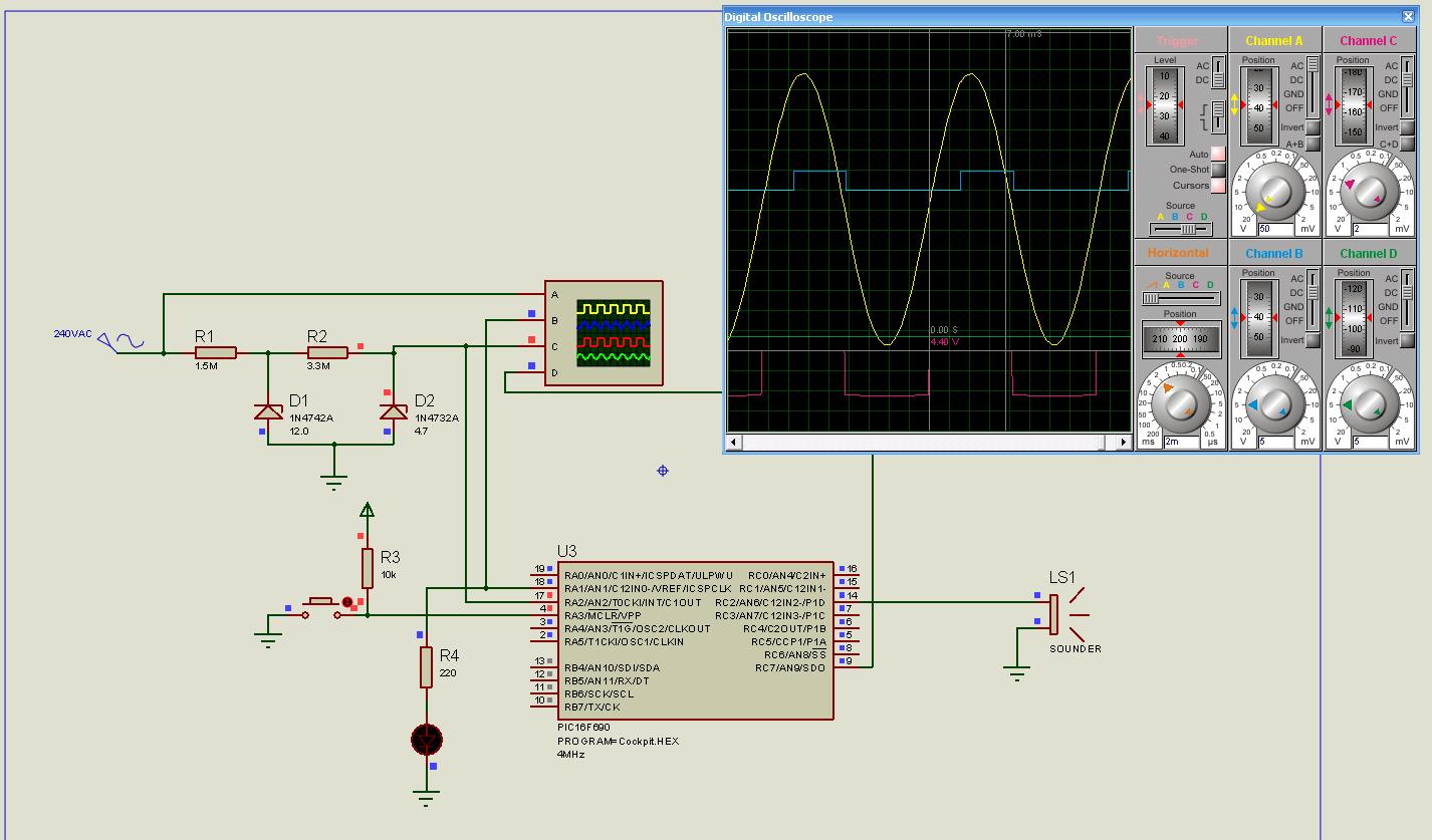

    Very interesting thread I must say. I am trying to do the same and have added DT_INTERRUPTS to manage the ac detect....But my lamp is not dimming at all, also when in the code 'triacdelay=0', my lamp does not go off........ Can someone spot the error please.
    INCLUDE "DT_INTS-14.bas"     ; Base Interrupt System
    INCLUDE "ReEnterPBP.bas"     ; Include if using PBP interrupts
    Include "modedefs.bas"
    @ __Config _XT_OSC & _WDT_ON & _PWRTE_ON & _MCLRE_OFF & _BODEN & _CP & _CPD
    TriacDelay                  var Word
    maxdelay                    var word
    Triac	var	PortA.1 ' Output to TRIAC gate
    ACLine	var	PortA.2 ' Input for the FullWave rectify AC line
    Buz		var PortC.2
    TRISA = %001100
    TRISC = 0
    CMCON = 7
    ANSEL = 0
    OPTION_REG = %11000000  ' RAPU = off, PS WDT
    PORTA=0
    PORTC=0
            INT_Handler    INT_INT,  _ACDetect,   PBP,  yes
    @   INT_ENABLE   INT_INT     ; enable external (INT) interrupts
    Triac=0            ' disable Triac Gate
    triacdelay=0  ' Set delay to minimum
    while 1
    pause 3000
    high buz: pause 500 : low buz
    triacdelay=8000     : pause 10000 :high buz: pause 50 : low buz
    triacdelay=5000     : pause 10000 :high buz: pause 50 : low buz
    triacdelay=4500     : pause 10000 :high buz: pause 50 : low buz
    triacdelay=4000     : pause 10000 :high buz: pause 50 : low buz
    triacdelay=3500     : pause 10000 :high buz: pause 50 : low buz
    triacdelay=0 : pause 7000
    wend
    ACDetect:
    	if triacdelay > 0 then
    			if triacdelay=8000 then
    				triac=1 ' Activate TRIAC
    				maxdelay=8000-triacdelay
    				pauseus maxdelay
    				triac=1
    				pauseus 50
    				triac=0
     		     triac=0
    @ INT_RETURN
    P.S. I am using full wave with few high value resistance connected to phase and zeners to drop the voltage further.
  20. #60
    Quote Originally Posted by FromTheCockpit View Post
    What size zeners are you using?
    The INT input is Schmidt trigger, so it has to get above 4.0V to trigger the interrupt.
    It may not make it, or cause a delay after zero-crossing that could affect the timing.
    Have you tried it without the zeners?
  21. #61
    Question
    Hello Darrel, I made a slight mistake in the above post, it's not full wave rectified. The circuit goes like this - Phase->1.5Meg->12V zener->1K->4.7V zener->3.3Meg->PIC
    No I have not tried it without zeners yet. Will it be OK to remove the zeners from the above equation - the place where I am gets heavy voltage fluctuations - The variation could be from 170V - 280V AC (I am serious!)

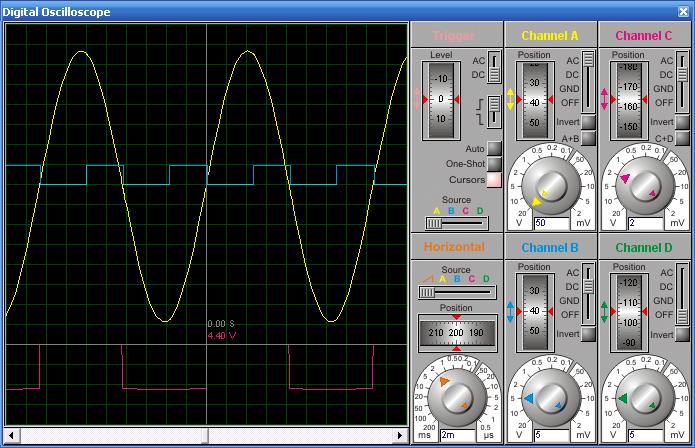

    According to the simulator, your resistors/zeners should give 4.4v, so that's ok. (but you shouldn't need the zeners)
    mister-e was using INT ON CHANGE, so it triggered on both edges.
    To get INT to do the same thing you have to toggle INTEDG on each interrupt.
    This modification of the handler works in the SIM.
    INTEDG  VAR OPTION_REG.6
    ACDetect:
        if INTEDG then
                    pauseus maxdelay
                    triac=1
                triac=0
            if triacdelay != 8000 then triac=0
        INTEDG = !INTEDG
    @ INT_RETURN
    In the scope image, the blue line shows the triac ON time.
    It's only on during the positive half of the cycle.
    Doesn't seem right, but that's the way mister-e had it.
    HTH,

    Thanks Darrel, I just noticed that in your simulation there is no 1k between the two zeners, instead there is 3.3Meg. I will try the code and update here.

    You're right, I had the resistors wrong.
    Making the change brought it up to 4.6V.
    But, having the zeners in there adds about 40uS to the zero-cross signal.
    It takes 35uS without the zeners, and 75uS with them.
    Add in the interrupt latency for PBP type interrupts, time to do math in the handler, the minimum pauseus of 24us, and taking into account that a half cycle of 60hz is 8,333uS ... I'm sure the first step was quite a bit dimmer.
    But the biggest problem is delaying inside the interrupt handler.
    When 90% of the time is spent in the handler, the pause 10000 in the main loop takes almost a minute.
    So here's my next attempt.
    It uses Timer1 for the delays, so the main program can keep running in the foreground.
    The handlers have been changed to ASM type to minimize latencies.
    And the math is done in a separate subroutine that only runs once when you change the brightness, instead of having to do the math on every zero-cross.
    It should be pretty close to the MAX/MIN dimming, but you may need to adjust the MaxBright/MinBright constants a little.
    If you adjust them too far, it will start flashing.
