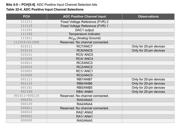

    First, I had to find out the correspondance between Pin and Channel (I'm using a 20-pin device). Here it is:
