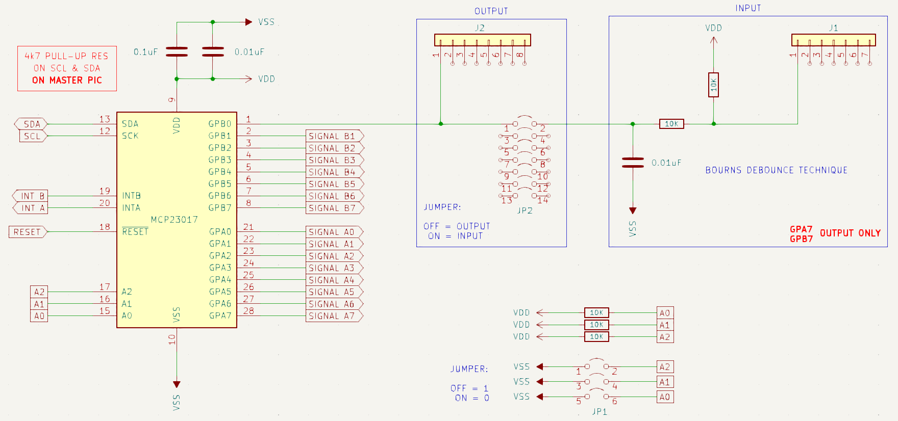

    Circuit looks like this:
    Name:  PCB I-O Expanders v3 circuit.png

    Default Re: I/O expanders
    Am I the only person that can't stand having VSS above, and VDD below?
    I had to go and fix the caps so VDD was above, and VSS below.
    Name:  PCB I-O Expanders v3 schematic.png
    4,174
    No, you are not alone! Don't like it, can't stand it!
    And bothers me alot when schematics from big companies do that on purpose, to just make your day miserable!
