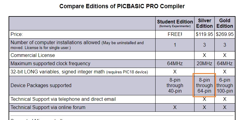

    Hello, I'm currently using the student PBP3 with Micro Code Studio version and I have a project to use some PIC10F322 / 6 pin chips.
    on the devices list of the PBP3 silver edition this PIC it's included, but on the "
    Compare Editions of PICBASIC PRO Compiler" it is listed chips of 8-pin through 64-pin.
    I asked MELAB about this and they reply by sending me the link of the PBP3 edition device list.
    I assume it's will work but like to know just before buying the silver edition.
    Thank's
    Name:  pbp3 editions.jpg

    Hello, and thank's for the reply, I know the list it's included, but I'm concern about is the 6 pin chip (not the 8 pin) will work
    this is my request.

    Default Re: PIC10F322 6 pin chip
    The 6-pin and 8-pin versions are exactly the same only packaged differently.
    The 8-pin package has 2 pins that are N/C so there really is no difference and no reason why it should not work with the silver edition despite the "matrix" saying 8-64pins.
