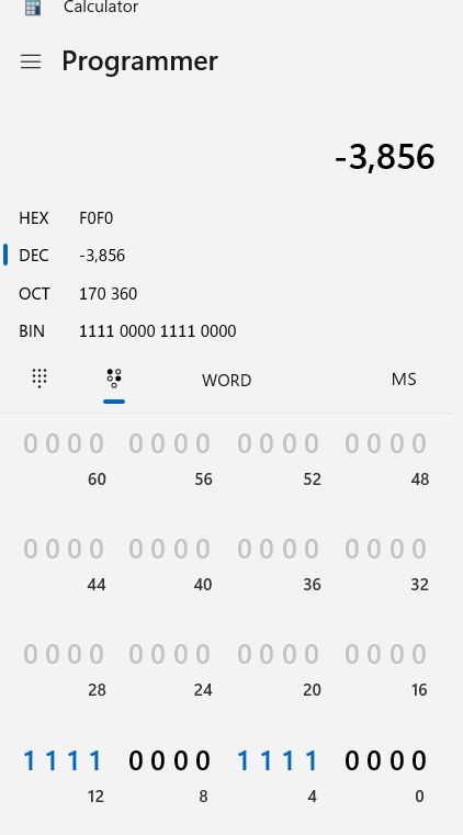

    Or, 1 0000 1111 0000 is also negative and the value is -3856
    This is confusing to me. I get the positive and negative thing but I can't figure out how you come to this 3856 number?

    Default Re: MCP3301 A/D converter SPI reading
    to expand a 13 bit negative two's complement number to a 16 bit number bits 13,14 an 15 need to be set accordingly
    in general the "sign bit" needs to be extended to the new width
    so 1 0000 1111 0000 becomes 1111 0000 1111 0000 qed -3856

    4,171
    Yes, Richard is correct. I forgot to mention you have to adjust the value to the byte, word or whatever width you have.
    So the sign is the left most bit but the rest should also be 1. Remember we reverse the bits to get the absolute value disregarding the left most, sign bit.
    Seems confusing at first, but has its logic.
