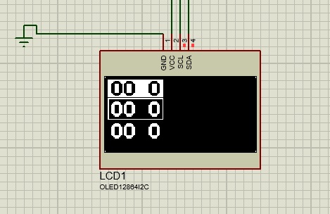

    2,696
    Default Re: SSD1306 Inverse screen example?
    to invert entire display
    SSDC $A7
    to restore it USE
    SSDC $A6
    I was thinking
