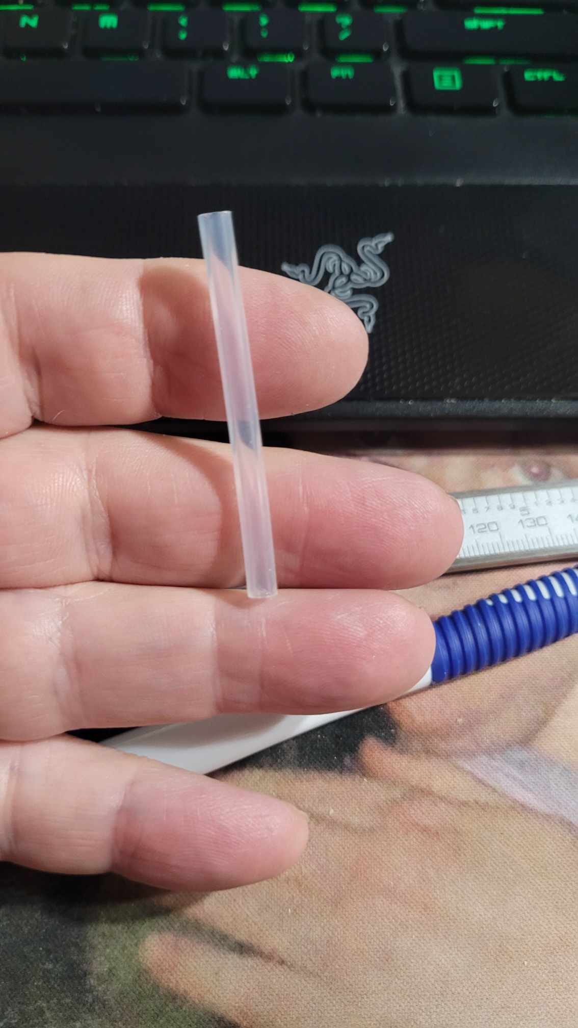

    Careful when you open the package. Mine came with a longer tube for repairs.
    Name:  Solder vacuum hose.jpg
    4,175
    Default Re: Solder suction/pump
    There are replacement silicon tubes available. Not the teflon rubbish...

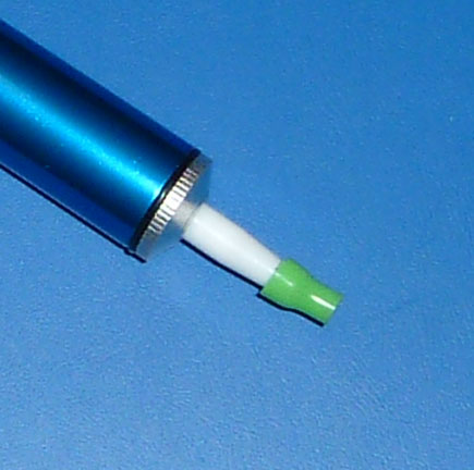

    I've just tried a bit of model aircraft silicone fuel pipe on my blue solder sucker and it now works a lot better. The original teflon tube needs shortening a bit so the nozzle / fuel tube can be cleared of solder. Clear silicone fuel tube would be better.
    4,175
    That's a great idea!
    After cleaning the tube, what do you use for lubrication?
    Oct 2011
    54
    Never needed to lubricated it. Oil will clog up the bits of solder instead of them being ejected.
