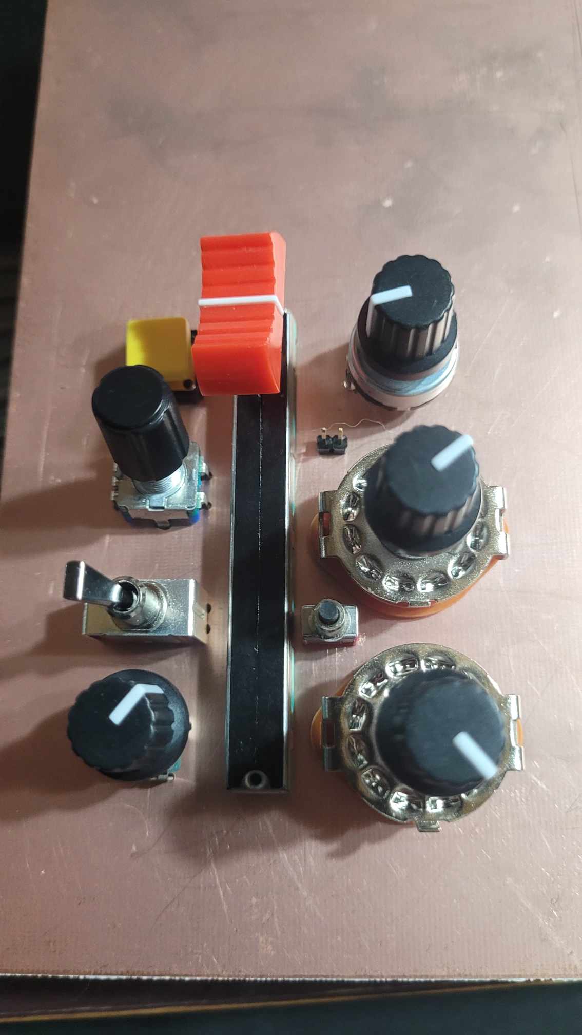

    I bought a Vevor mini-CNC last year . Had a few boo-boos, but Vevor made it right at no cost to me.
    https://www.vevor.ca/wood-engraving-...p_010386974707
    I never thought I could make a PCB with 0.5mm traces using el-cheapo bits on a $200CAD machine.
    (this is the bottom side, double-sided circuit is flipped vertically)
    I made 2 mistakes; error in the footprint for a slide potentiometer, and forgot a command for 2 oval holes when I editted the files from FlatCAM (I have to separate the drill and mill sizes - I don't have an automated tool changer).
    But still, I'm impressed that we can now make at home such a delicate trace.

    Drilling and milling PCBs is awesome. It takes a bit of time to draw the test circuit on Kicad, import into FlatCam and generate g-code, import separate files into Candle, change the bits, align the Z axis.
    But this is waaaay more precise than a hand-held dremel, or even mounted on a vertical press. The only thing with the dremel is that it's much quicker setup, and you can tape a sheet of paper over the PCB with all the holes.
    It's a great way to test custom footprints before sending them out. Some specs ask for a huge hole. My components will be hand installed; I don't need such a huge margin.
