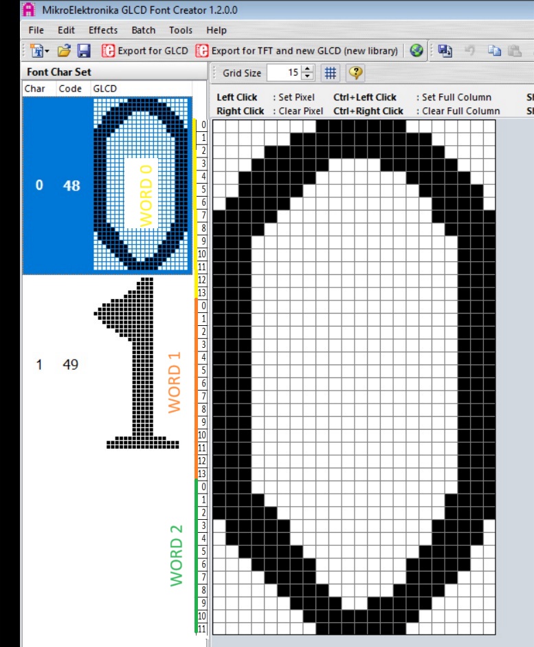

    the font is just a simple block of data
    this one is for digits 0 to 9 + "." + "%" its 14 bits high and 10 bits wide [to match chip flash]
    so total size is 120 words
    for convenience lets locate it a the end of flash - 120 words ie. 0xf88
    note this is only partially "filled" in and not very carefully at that
    asm       ;incomplete and very rough font 14x10
     org 0xf88
     dw    0x1ffc,0x3ffe,0x3006,0x3006,0x3006,0x3006,0x3006,0x3006,0x3ffe,0x1ffc ;"0"
     dw    0,0x300C,0x300E,0x300F,0x3ffF,0x3ffF,0x3ffF,0x3000,0x3000,0
     dw    0x3806,0x3C07,0x3E03,0x3703,0x3383,0x31E3,0x30F3,0x307F,0x303E,0
     dw    0x3018,0x3006,0x3186,0x3186,0x3186,0x3186,0x3186,0x3006,0x3cf8,0x1ffc  ;"3"
     dw    0,0x3ffe,0,0x3ffe,0,0x3ffe,0,0x3ffe,0,0
     dw    0,0x3ffe,0,0x3ffe,0x3ffe,0x3ffe,0,0x3ffe,0,0
     dw    0x3ffe,0x3ffe,0x3ffe,0,0,0,0,0x3ffe,0x3ffe,0x3ffe
     dw    0x3ffe,0x3ffe,0x3ffe,0,0,0x3ffe,0,0x3ffe,0x3ffe,0x3ffe
     dw    0x1ffc,0x3ffe,0x3186,0x3186,0x3186,0x3186,0x3186,0x3186,0x3ffe,0x1ffc  ;"8"
     dw    0,0x3ffe,0x3ffe,0x3ffe,0x3ffe,0x3ffe,0x3ffe,0x3ffe,0x3ffe,0x3ffe
     dw    0,0,0,0xE00,0x1F00,0x1F00,0xE00,0,0,0    ;"."
     dw    0x181f,0xC11,0x611,0x31f,0x1C0,0x60,0x1F38,0x110c,0x1106,0x1F02  ;"%"
    endasm
    normally i would make the font an include and give it a label rather than manually locate it like this
    dt's macro as found in dt-ints is ideal to find and numerate the font address
    GetAddress macro Label, Wout
    CHK?RP Wout
    movlw low Label ; get low byte
    movwf Wout
    movlw High Label ; get high byte
    movwf Wout + 1
    when the fonts address is known its simple to use readcode command to retrieve font data

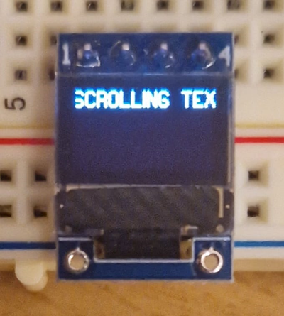

    Default SSD1306 OLED (72x40) I2C display from scratch - scrolling text
    Just for fun, scrolling text example
    Roger

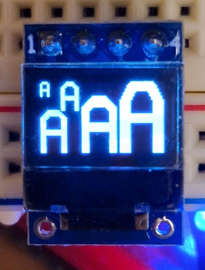

    i'm not seeing a font , i had a look at a 40x18 font this morning with my new 72x40 that just arrived
    encoded this way seems the best compromise for easy of unpacking into a 18 x 5 byte stream to send to display

    i have tried a 14x10 , a 14x10 doubled to 28x20
    a 13x7 doubled to 26x14 and tripled to 39x21
    they all work ok. imho by leaps and bounds a 40x18 full size font looks best and is only 540 words for ten digits

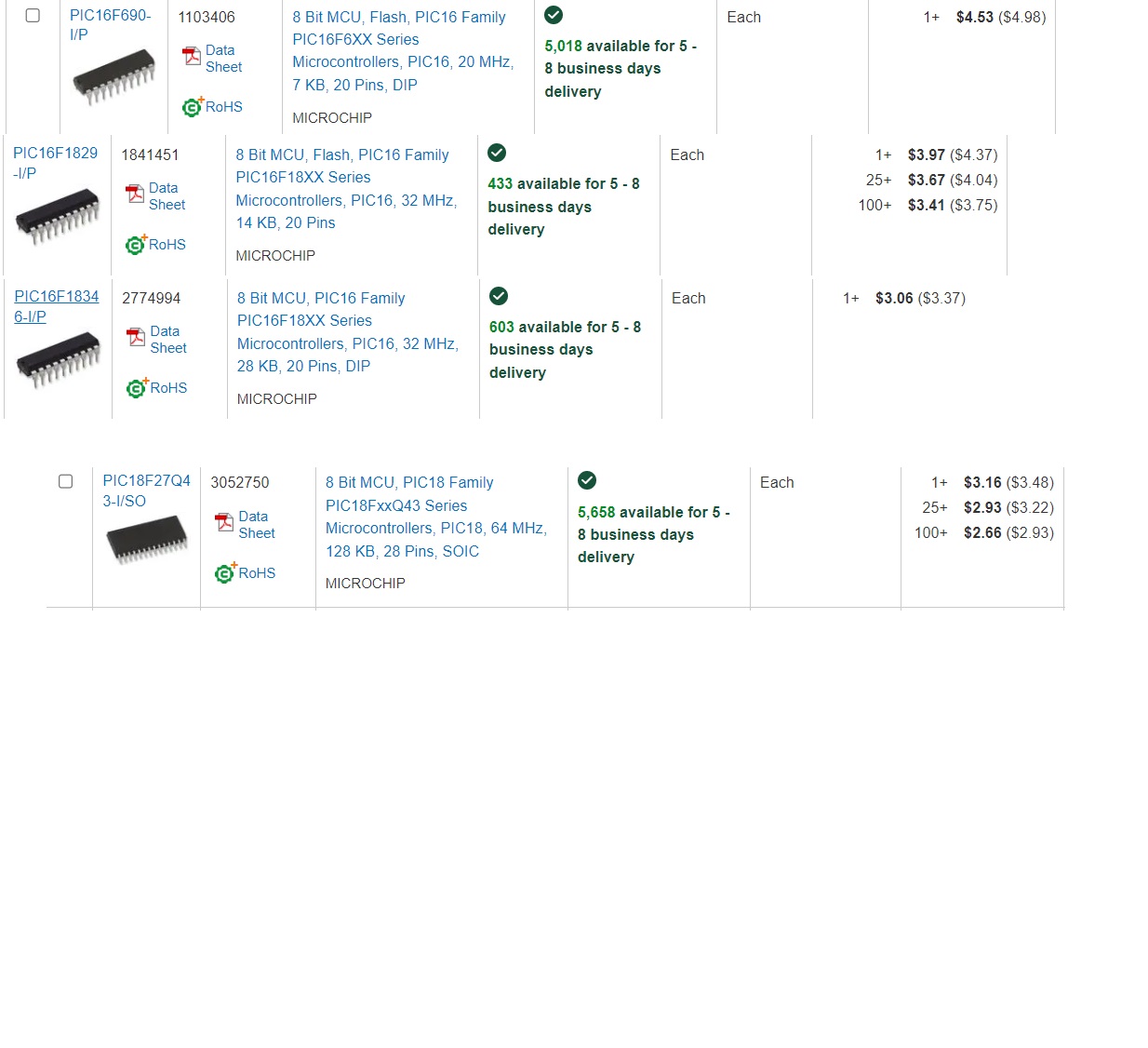

    because you can save your $1 and another one by buying a better pic to start with and :-
    not have a costlier more complex circuit board .
    use a standard font file generated by glcd font creator.
    its faster, uses hardware i2c and can do proper graphics too.
    as i said at the beginning if you want easy get a pic 18

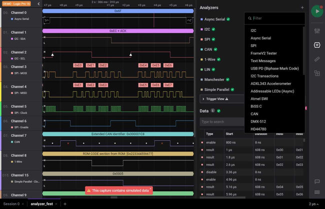

    Use a logical analyzer to see if the module responds to "Initializing command set" when it fails. If it doesn't respond you can try a longer pause "PAUSE 500 ' let display settle".
    Check that you don't have any noise in the power lines or control lines.
    Anonymous
    How would I do this?

    Default Re: SSD1306 OLED (72x40) I2C display from scratch
    Connect a logical analyzer to tx and rx. They are not expensive. Digikey has one for $20. You can see the ones and zeroes going to the module and coming back to the pic. If you don't use a logic analyzer, it is like shooting in the dark.

    I use a Saleae analyzer with 16 channels. It makes my life a lot easier.
