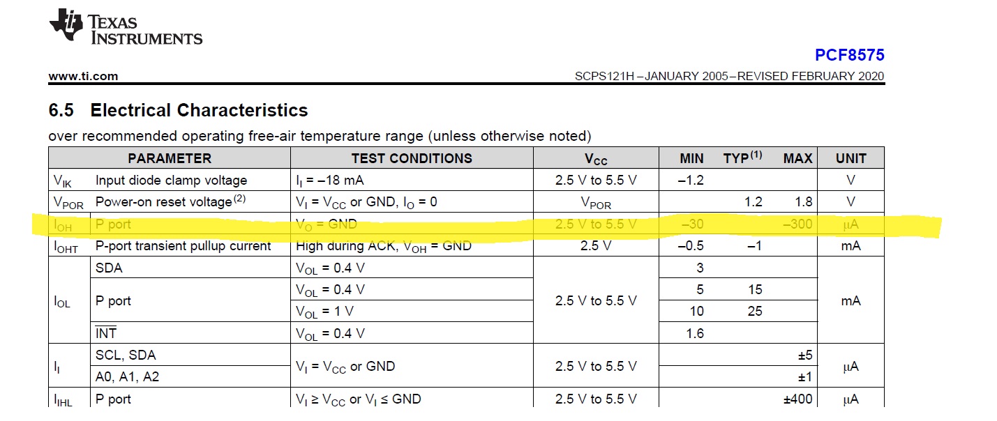

    no , it can sink 25mA ,source 300uA

    4,170
    Default Re: PCF8575 Does not work with my code....
    Correct! But what about the charts on page 7?
    Feb 2013
    1,156
    I measured short circuit current of PCF8575 outputs. It is roughly 0.16mA.
    2,692
    perhaps you should write to them , the graphs in figures 8,9 and 10 are questionable . perhaps the scale should be uA not mA
    4,170
    The ULN2803 needs at least 0.35mA, so practically 8575 cannot drive it with enough current.
    Seems the datasheet has many errors...
