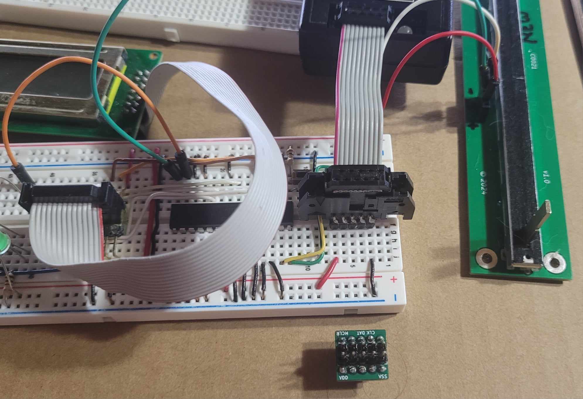

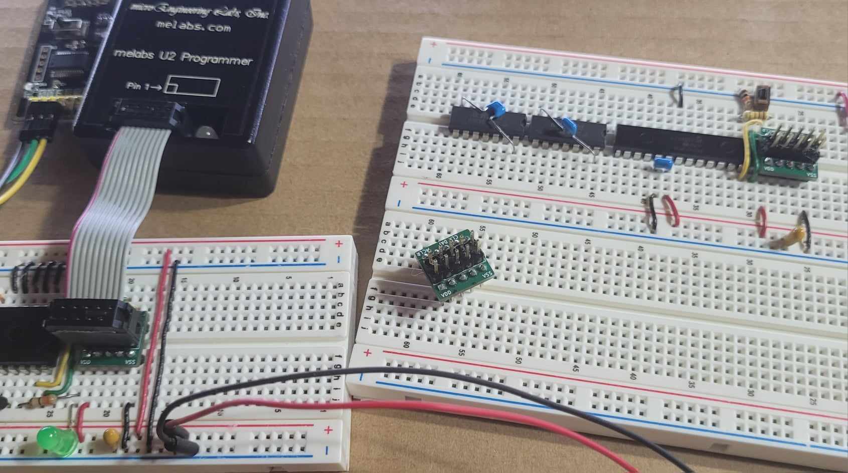

    MeLabs USB programmer header; costs $5.88cad at JLCPCB for 20.
    Name:  Pgm headers a.jpg
    So now I don't even worry about moving my cumbersome DIY programming header around.
    Name:  Pgm headers c.jpg
    And the pins are labelled so I don't have to keep digging up the specs to know what-goes-where. I could have made the pads a big bigger though.
    I also made a 2x7 pin version for the 44780 LCD at the left. Those LCDs come in handy for debugging.

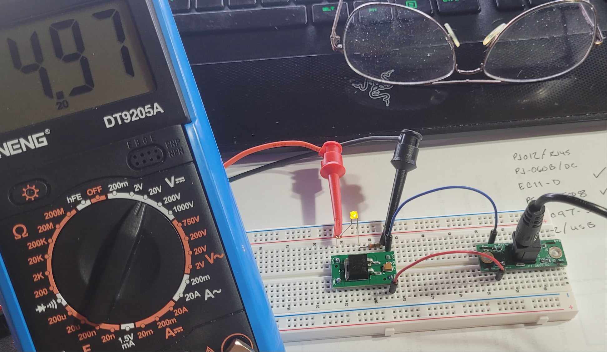

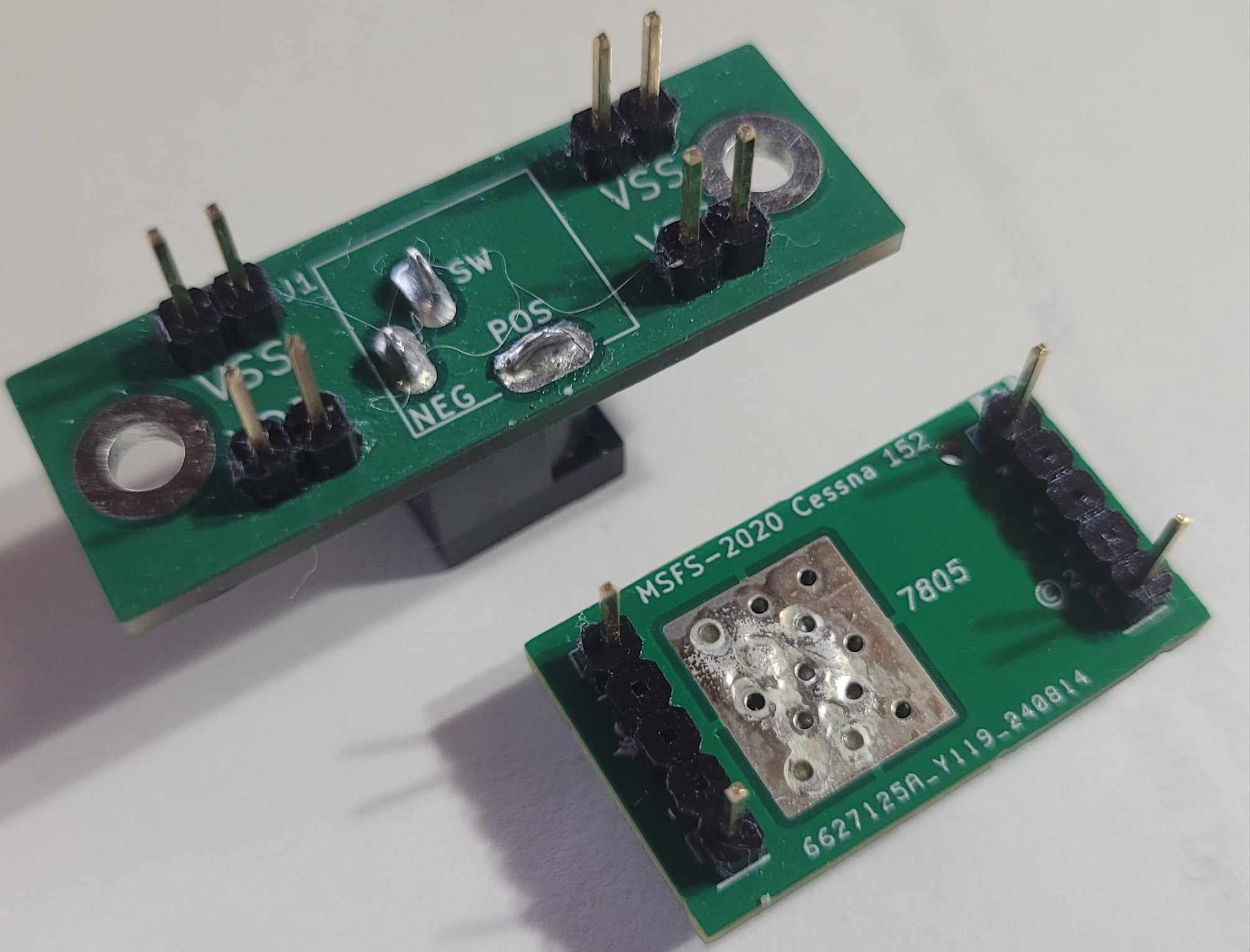

    Modular circuits; a CD jack on the right with a 7805 voltage regulator. I bought a bunch of breadboards over on amazon, so I just leave them on the breadboard and can quickly test something related with "power". Just make sure your pins are spaced like on your breadboards (2.54mm usually).
    Name:  Modular circuits.jpg
    Tip #1: I sacrificed my worst breadboard and use it to solder my modules. That way the header pins are always perfectly straight.
    Tip #2: Instead of using double-pins cause singles are annoying to hold (like on my DC jack module), use a full-length header but remove the unneeded pins (7805 module):
    Name:  Power modules.jpg
    Tip#3: you can determine where JLCPCB puts their order # on your PCB, just add JLCJLCJLCJLC wherever you want (see bottom of 7805 module above).

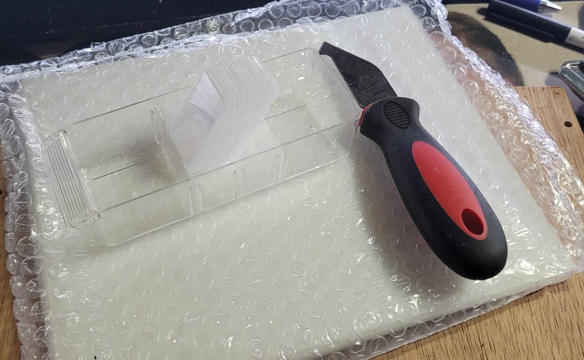

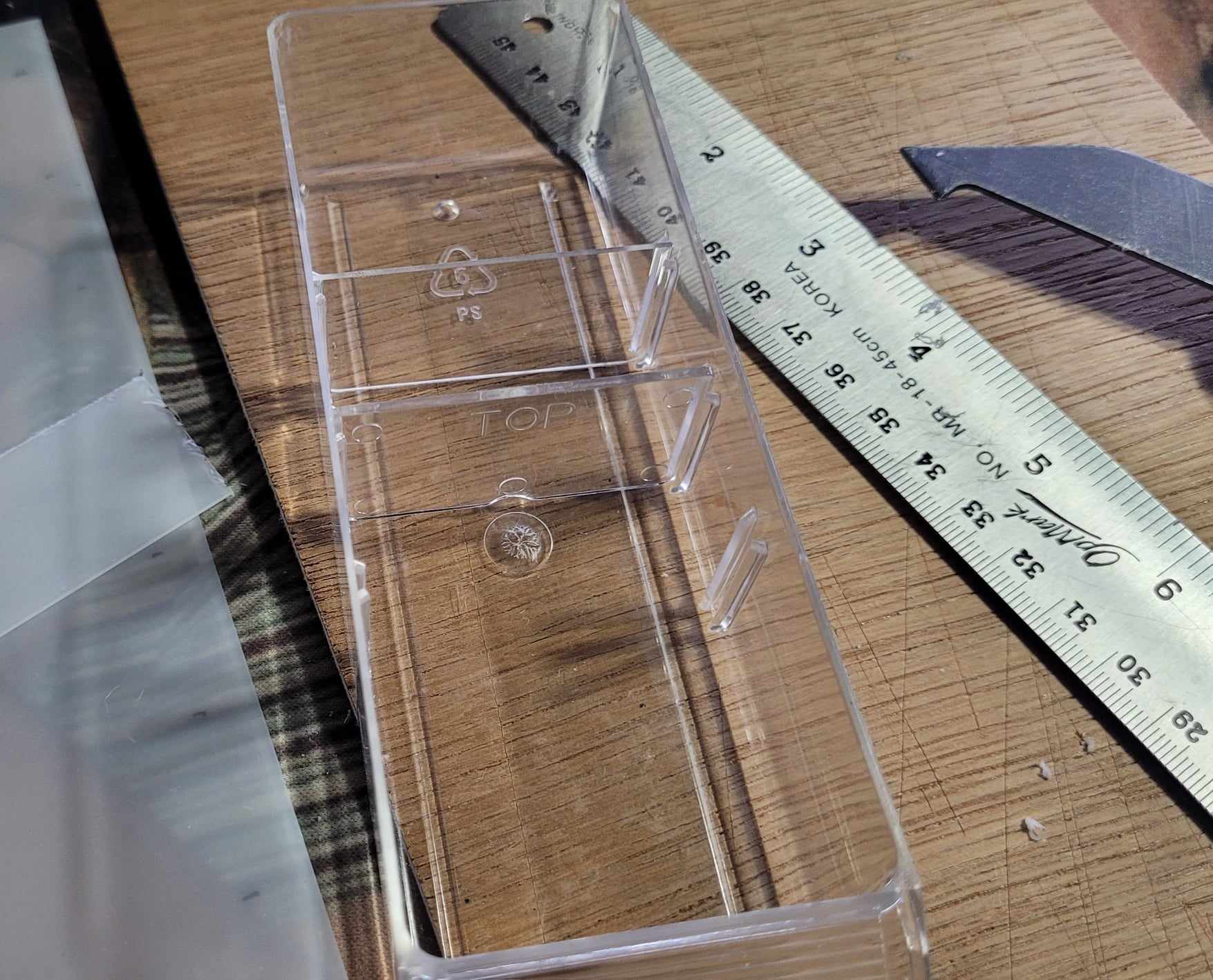

    Need drawer separators and are fed up with crappy cardboard?
    1mm plexi from amazon:
    https://www.amazon.ca/dp/B09XV459GR?th=1
    And get a cutter for plexi and a steel ruler; don't try with an exacto, they tend to wander a bit more.
    Now I wished I had fabricated a small cutting table last summer.
    Name:  drawer seperator.jpg
    The front one is an original.
    I use 100grit sandpaper to round out the bottom corners.

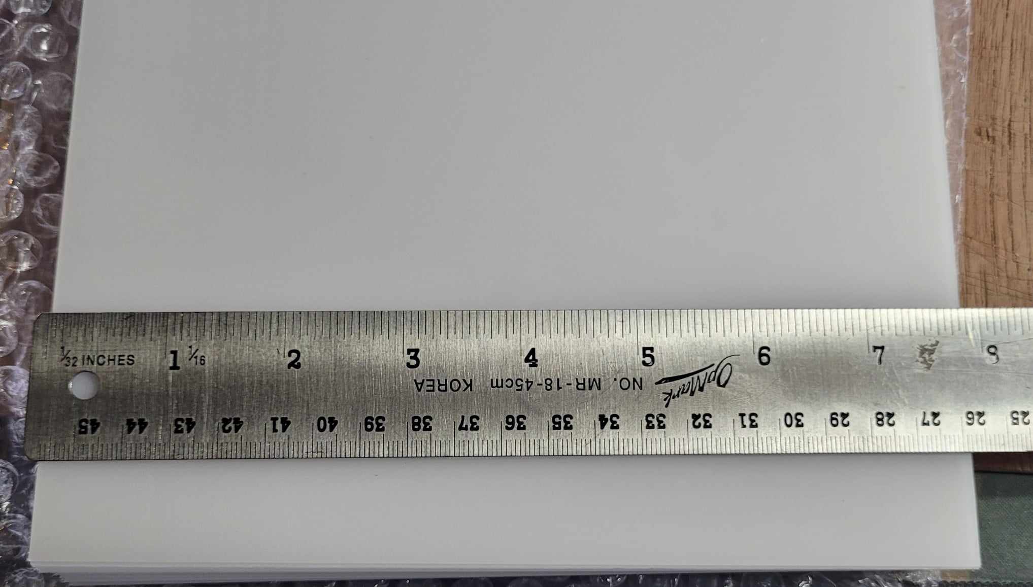

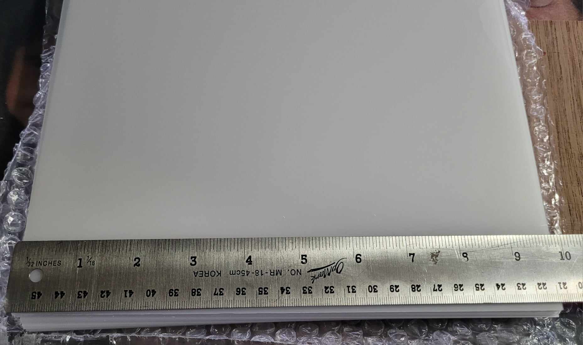

    Just be warned, the sheet isn't exactly 8x10in.
    Name:  Drawer separator results b.jpg
    Name:  Drawer separator results c.jpg
    I didn't measure first and started cutting. I could have gotten at least 31 separators of 1x2in, but I only got 27 cause I wasn't paying attention to cutting that last slice in the other direction.
