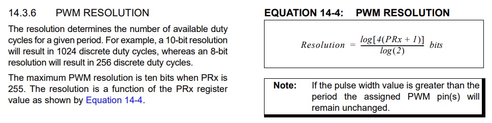

    I found in the manual what you said regarding the Resolution bits.

    the duty cycle is a 10 bit value at best for that chip, not all frequencies can have the full 10bit range available
    it totally depends on choices made with regard to prescaler and period.
    no matter what bit resolution is possible the CPRxL value is the upper 8 bits of the duty cycle word valueCCP1CON bit 4 and 5 are the lower two bits

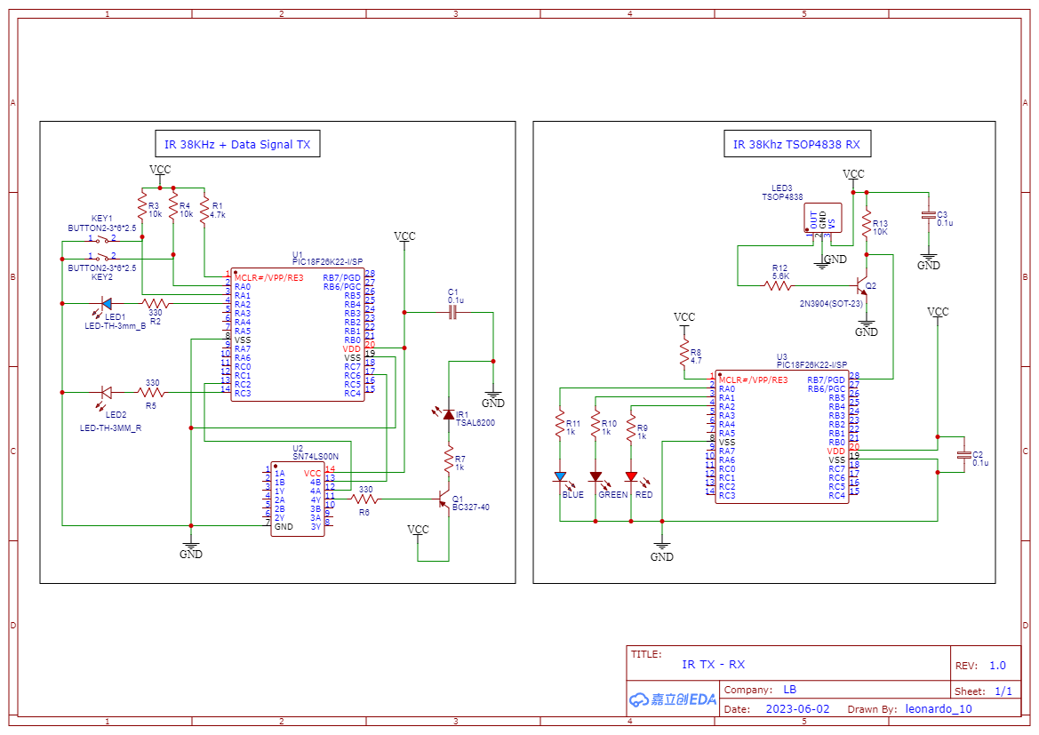

    Yesterday i tried till late at night to set a code for the TX and RX, a very simple one but didnt work.
    how are the chips connected , show a schematic

    I will make the schematic on paper later today and will upload it here.
    thanks

    Please find the schematic as follows.
    I hope i didnt forget anything. In any case is very simple.

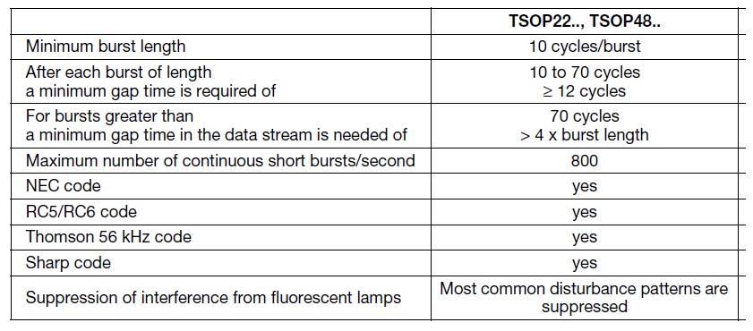

    if you look at the data sheet for a tsop4838 you will see that you have a numbers of issues to contend with
    1. @9600baud the bit time is 100uS or approx 4 cycles of 38khz , about 2 to three times faster than the tsop4838 can cope with
    2. the max burst rate is 800/sec a 9600baud stream can exceed that
    3. after a 70 cycle transmission a 12 cycle min tx gap must be made [some devices can lock up if u don't and need a pwr cycle to recover]
    4. the device will do its very best to reject a continuous transmission and go mute till a min tx gap in tx is observed, which is what you are doing.
    overall tsop4838 is not particularly suitable for serial tx from a uart, you could try a much lower baud rate and you will need to
    invert the transmission logic so that there no transmission at idle
    i would also wire tx to rx directly to verify code works before trying ir link, also have a look at Manchester encoding and check out ir tx protocols like RC5/6 NEC etc
