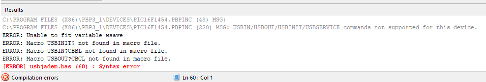

    Has anybody tried to make a USB project with a PIC16F chip? I'm trying to make the PIC16F1454 work with USB, but I'm getting this error from PBP3 "USBIN/USBOUT/USBINIT/USBSERVICE commands not supported for this device." This chip has USB capabilities. This error makes me think that PBP3 doesn't support USB in PIC16F chips. Any advice or comments are greatly appreciated.
    The error in red comes from me trying to include the usbjadem.bas descriptor.
    I'm just trying to initialize the USB with usbinit and it is not working. My basic preliminary code below.

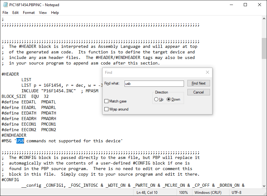

    Default Re: PIC16F1454 Connecting To USB Doesn't Work
    Ah crap.
    If I search USB in PIC18F4550.PBPINC, I get this:
    If I do the same search in PIC16F1454.PBPINC:
    That messes up my plans as well for an inexpensive USB PIC.

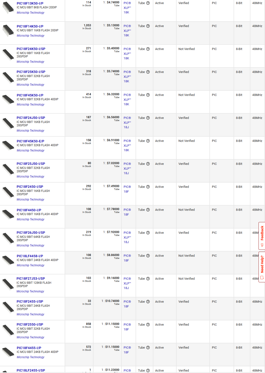

    Holy crap, prices rise quickly.
    DigiKey:
    Name:  Digikkey USB PIC prices.png

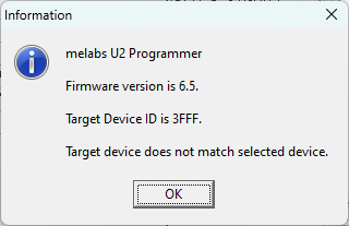

    Hmm, I made it work for a flashing LED. This is weird, you need to power the 16F1454 chip with 5V. It won't get programmed if I power it with 3V. I have never seen this for a regular 16F chip.
    Yes, that post from the forum was very helpful. He had some issues programming the chip too.

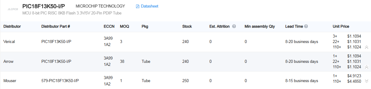

    I just hit a sweet deal. At that price, I cleaned out everything they had on hand:
    Name:  18F13K50 bargain b.png
    These go for $3.91 / 100 at Digikey.
    Attachment 9860
    Those chips are the cheapest 18F with USB according to the Microchip Advanced Selector Chip tool. I'll order some and give it a try.
