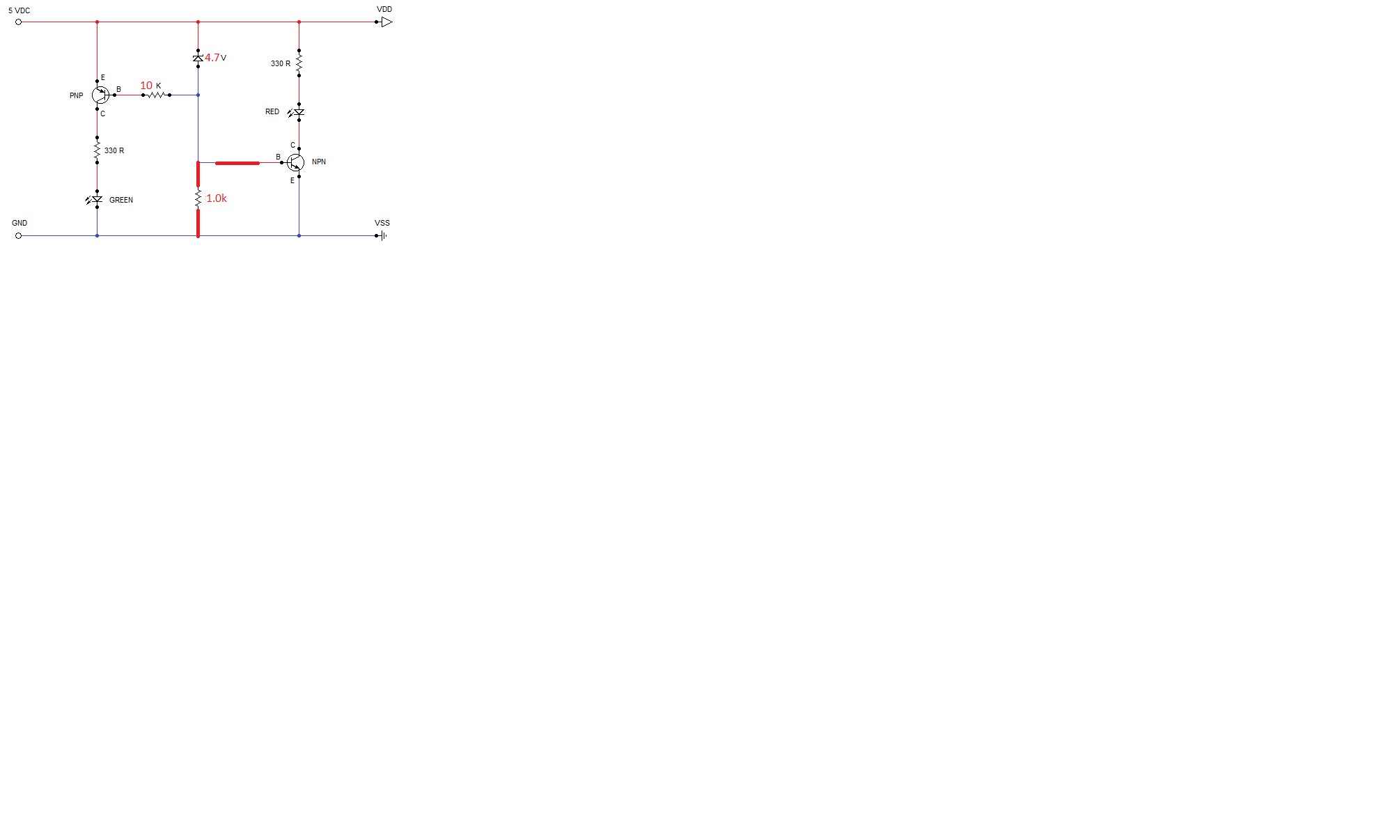

    the red led will never fly with base of tr shorted to gnd
    try
    red should light at 5.5v

    But why reduce Zener to 4.7V? Out of all the PICs I'm looking at, the one with the lowest max VDD was 6.0V; hence why I chose 5.6V Zener as "fuse".
    Is this because of influence of 1K resistor below it?
    And how did you arrive at 4.7V? Math? or a spec in some doc?
    i saw
    the 5V model supplied with the unit
    and assumed an over 5v alarm was indicated
    if you use a 5.6v zenner in my cct then the red alarm led will be lit at 6.5 v

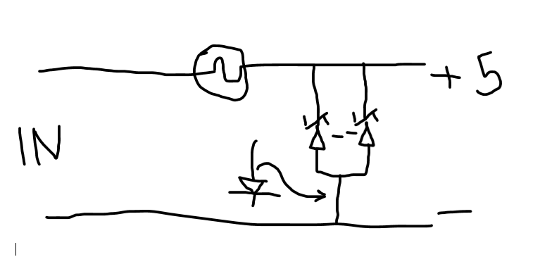

    A simpler circuit as 'crowbar' type circuit. Use 2 or 3 -5.6 volt zener diodes, if/when it trips, probably will short/ruin one z-diode. Has your .6 amp fuse and you can add one or more 1n4004 type diodes in series to raise the trip-out voltage by about .6 volt for each diode. Also add a, maybe a
    1 or 10 microfarad cap across z-d's to absorb any high surge if over 5v

    for low power mains powered roles they served well for years and still can
    absolute vin max is 35v but dropping 20v or so across the reg @250mA makes a lot of heat whereas for a switching reg , no heat
    4,184
    Default Re: Over-voltage protection
    Maybe I missed the scope but, why are you so worried?
    If you have a low current circuit, a 7805 is just fine for up to 35 or so voiltages.
    If you have higher currents, then a smps like the expensive Recom that Richard uses or the cheaper https://gr.mouser.com/ProductDetail/490-VXO7805-1000 I use is good enough.
    And last but not least, the circuit that you posted for reverse polarity protection with the p-mosfet in post #14 is the best protection with no voltage drop.
    I get crazy power surges and spikes here in thunderstorms, lots of trees messing with lines and transformers.
    I might end up using a combination of devices.
    Yeah, that diode was costing me .7V and was bugging me like crazy, but with that boost circuit, that's not really a problem. That boost circuit also gives me the choice of splitting my power source: 5V for PIC and other ICs, and what ever I need for more power-hungry circuits.
    I have only one major concern, whatever I chose, I have to be able to provide at least 100 within a year, hopefully 1000 over the next few years (gotta have goals in life ).
