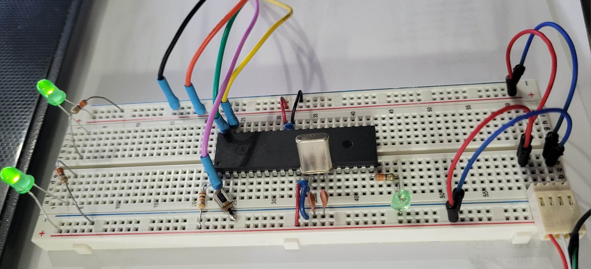

    Started trying to get USART going on the LAB X1, but was getting garbage - couldn't figure it out, so I moved to a breadboard and started at the beginning. It doesn't get much more basic than this on a 16F877; blinky on pin D1.

    • I added two power LEDs at the top to show both rails are powered.
      Blinky LED is on pin D1, and yet nothing happens.
      LED comes on if I manually apply 5V to pin.
      I've changed 20MHz OSC and caps.
      Changed MCU.
    I've been trying to figure this out for waaaay too long now, I feel I'm getting dumber by the minute.
