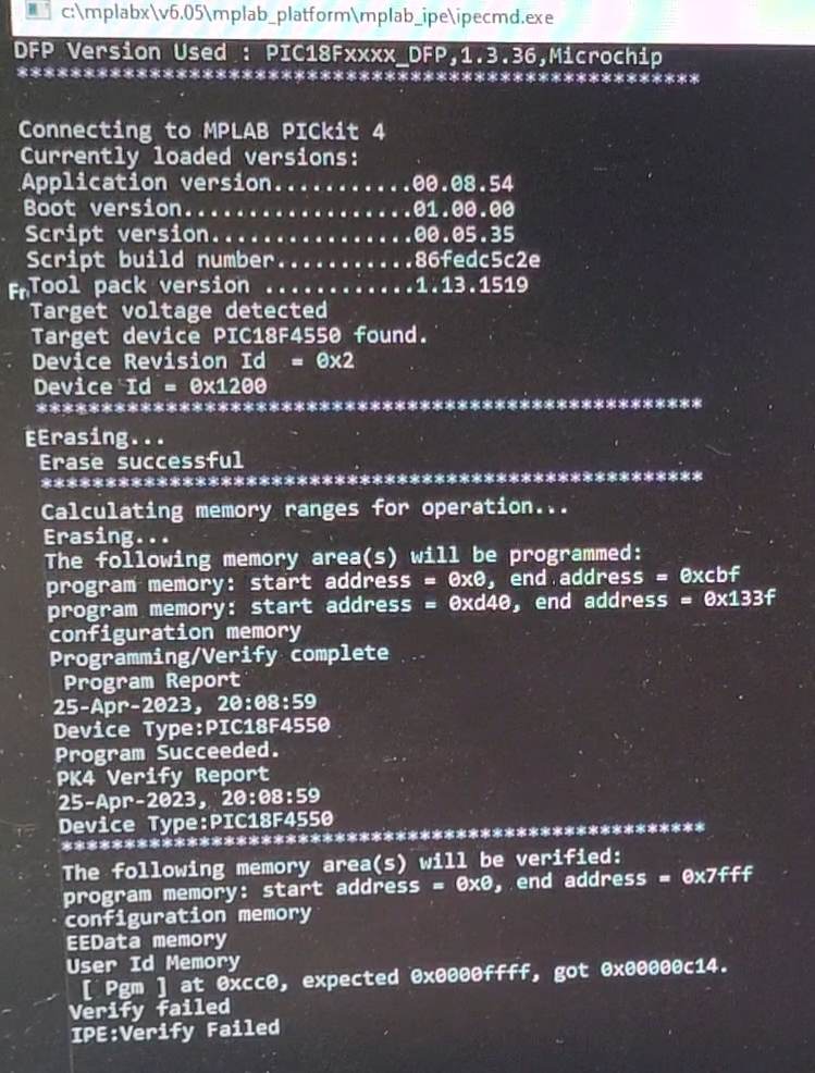

18F4550 programming failed using PICkit4 while verifying "User ID memory"
Results 1 to 20 of 20
    Question 18F4550 programming failed using PICkit4 while verifying "User ID memory"
    Any idea what it's crying about?
    Name:  18F4550 verify failed.jpg
    I had to slow the programming speed to SLOW or else I'd get speeding errors.
    Program, configuration and EEdata memory seem to verify just fine. It looks like it failed at "User ID memory" - whatever that is.
    This was programmed 15 years ago; no idea what's on that memory location.

    Default Re: 18F4550 programming failed using PICkit4 while verifying "User ID memory"
    Out of curiosity, did you try the PIC to see if it actually programmed? Usually the "User ID Failed" shows up before it even tries to program. Just asking.

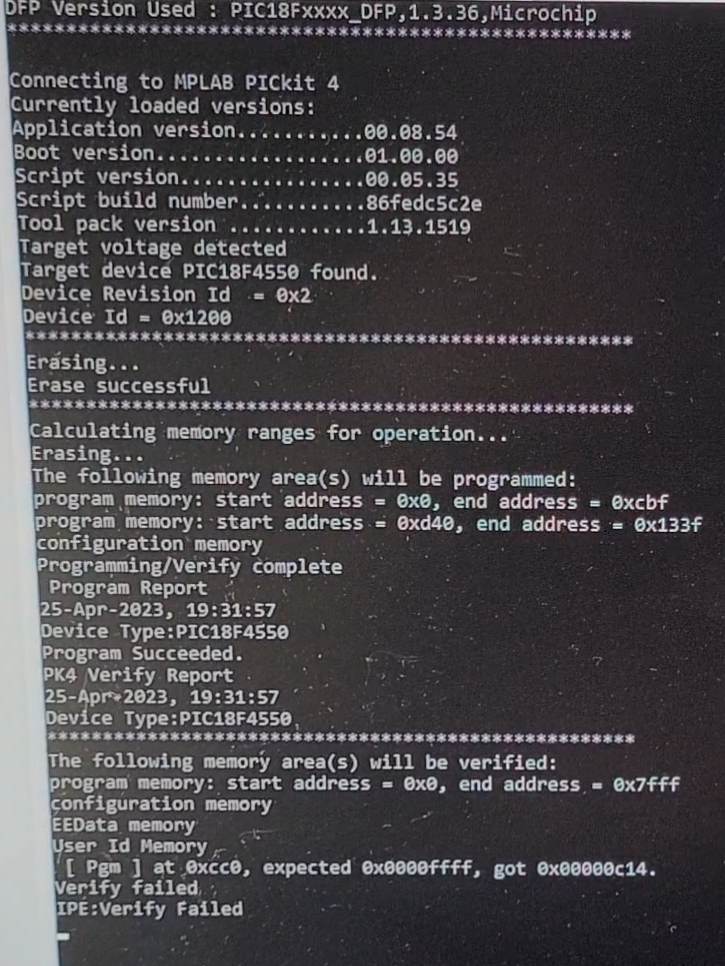

    So I tried with a brand new 18F4550, same error:
    I don't think it's complaining about the UserID area, it's just a poorly arranged display making it look that way.
    The UserID is located at 0x200000-0x200007 in that part.
    It looks to me that it's complaining about location 0xcc0, which is in program memory.
    Try doing an erase and then a blank check.
    There's a later toolpack for the 18F devices... maybe try updating it?

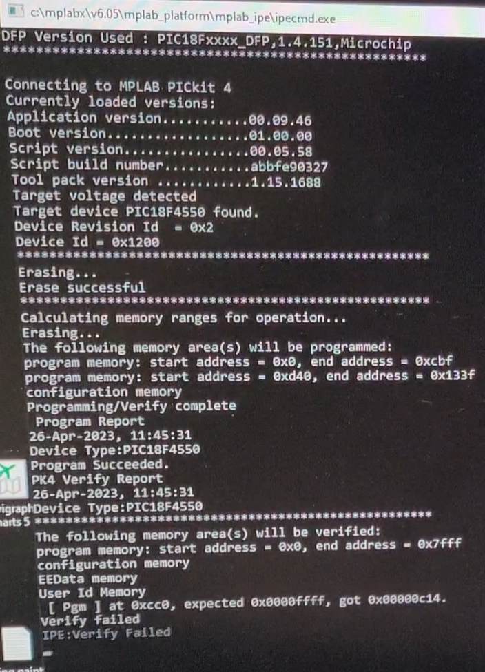

    Got a new pack, same problem.
    Name:  18F4550 new pack failed.jpg
    It already says ERASIN SUCCESSFUL midway down the pic.
    Gutted all the USB and interrupt stuff, added just a basic blinky, and it worked.
    Is there an option on PickIt 4 to erase the chip before write?
    When I had such messages the above solved the problem.
    Aug 2011
    461
    If you look at the messages, when it fails the program end addr is 0xcbf.
    It's then not seeing the next addr 0xcc0 as erased... there's still something there.
    I think there's a setting to specify the full range and not let the PK4 pick it.

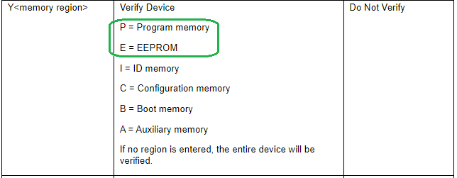

    Since I had never paid attention to a command line when I was using my old serial and later USB programmers, I had no clue what I should "verify", so, I verified everything.
    Name:  PK4 verification.png
    Turns out it doesn't like when I verify ID Memory and Configuration Memory.
    This is my new command line for the PICkit 4:
    -TPPK4 -P$target-device$ -F$hex-filename$ -E -M -OAS0 -OB -OL -OV -YP -YE
    Note that I "might" be verifying the Programming and EEData areas a 2nd time for nothing. But hey, I paid for it so I'm using it.
    Name:  PK4 program and verify.png

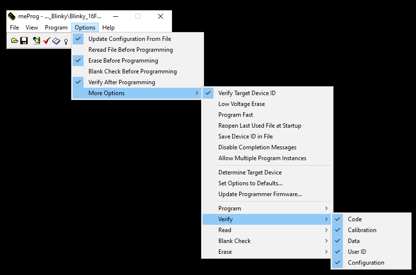

    This is what my U2 does.
    Erase:
    Name:  U2 1 Erase.png
    Program:
    Name:  U2 2 Program.png
    Verify:
    Name:  U2 3 Verify.png
    These are the settings I have for the PK4:
    -TPPK4 -P$target-device$ -F$hex-filename$ -E -M -OAS2 -OB -OL -OV -W -YP -YE
    E = Erase Flash Device (there are no options)
    M = Program entire device (does not include calibration, same like U2)
    OAS2 = Maximum programming speed
    OB = Batch mode operation (so the window stays open to check out the results)
    OL = Release from RESET NOT SURE ABOUT THIS GUY!
    OV = Verify device ID before program in batch mode
    W = Power target from tool
    YE = Verify EEPROM
    YP = Verify Program memory (U2 verifies Code, Calibration, Data, User ID and Configuration)
    If anything, the U2 should be waaaaay slower, it verifies more, and the PK4 is supposed to be running at max speed and it's plugged in a SS USB port.
    Weird...
