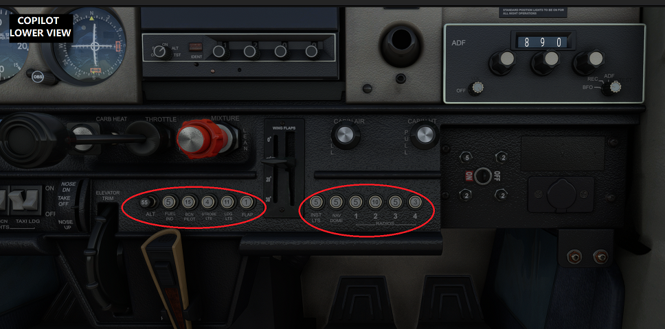

    One of the challenges I had given myself was to simulate an electric breaker in MSFS, just like the ones in a Cessna 152.
    Name:  Electric breakers 50pct.png
    So far, the least expensive and "good enough" technique was using a tiny solenoid and limit switch.
    I use an IRF730A TO220 mosfet for testing, but will switch to an AO3400A SMD mosfet later. Also, a 1N4001 as flyback diode. The 1000uF capacitor is not final, I still have to calculate that properly.
    I have a slight drop in voltage; don't know yet if I can do anything about that.
    Added benefit, "some" communication buttons can move to OFF under special circumstances. These electric switches can also be used for that purpose. They won't have the same feel and force as the other comm buttons, but at least i can print my own yellow caps and they'll behave exactly like in the game.
