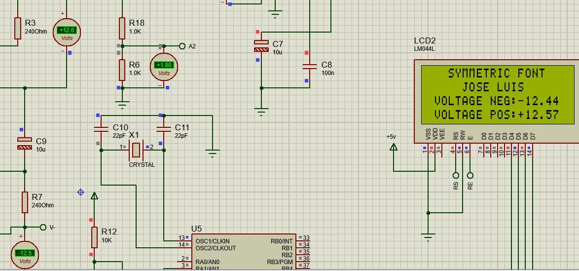

    I have solved the problem, I attach image
    Jul 2022
    26
    Cool Re: wrong positive and negative voltages on lcd 20x4
    Name:  Simulacion Corregida Fuente Simetrica (1).jpg
