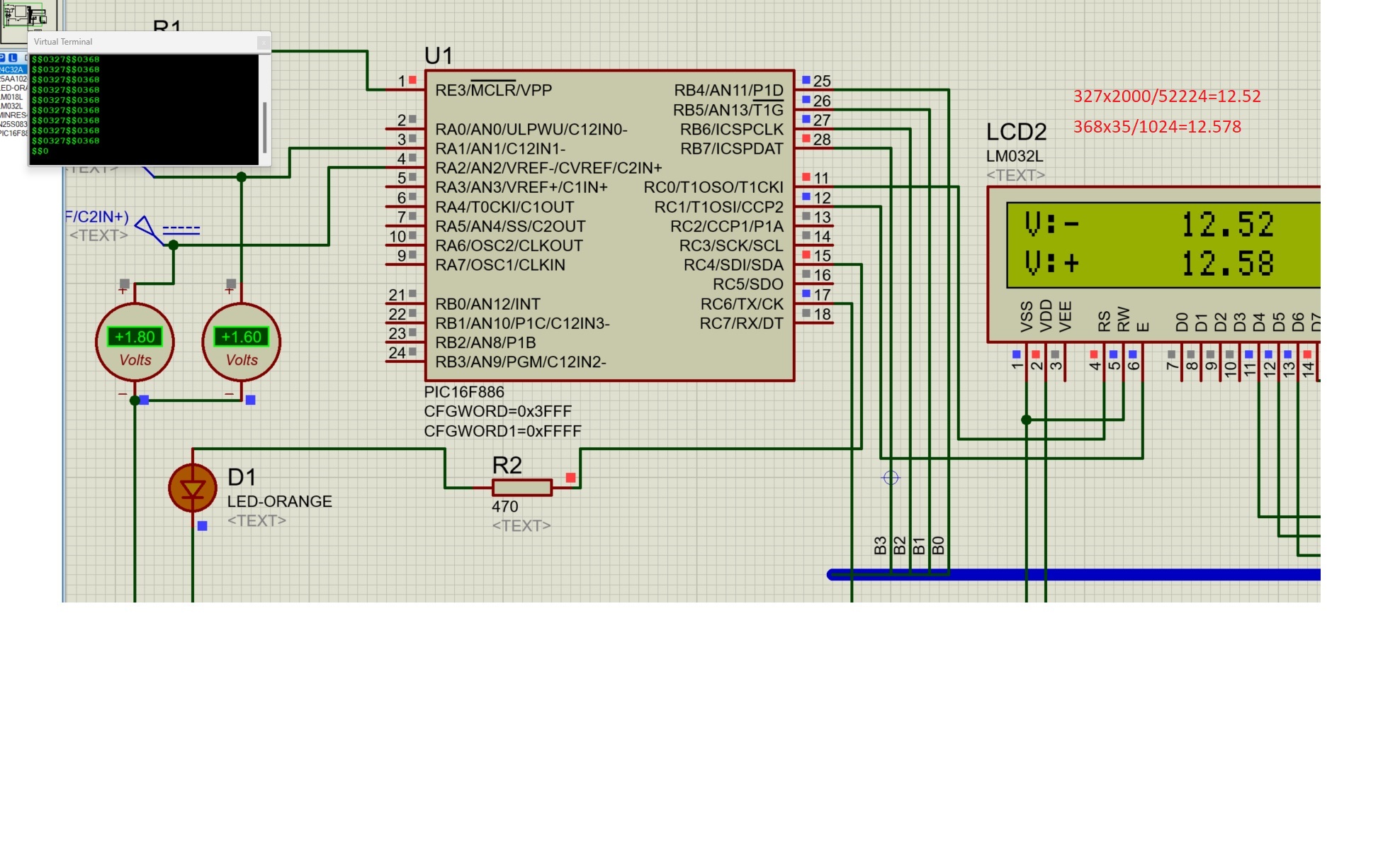

    2,699
    Default Re: wrong positive and negative voltages on lcd 20x4
    when corrected for a 2 line display as depicted in your code
    DEFINE LCD_DREG PORTB
    DEFINE LCD_DBIT 4
    DEFINE LCD_RSREG PORTC
    DEFINE LCD_RSBIT 0
    DEFINE LCD_EREG PORTC
    DEFINE LCD_EBIT 1
    DEFINE LCD_BITS 4
    DEFINE LCD_LINES 2
    it works in proteus much as expected
    Jul 2022
    26
    Name:  Problems with mathematical equations in Symmetric Font.jpg
    DEFINE LCD_DBIT 4
    DEFINE LCD_RSBIT 0
    DEFINE LCD_EBIT 1
    DEFINE LCD_BITS 4
    DEFINE LCD_LINES 2
    Attachment 9354
    previously I had this code using pic 16f877a​

    Name:  Simulacion Corregida Fuente Simetrica (1).jpg
    I have solved the problem, I attach image
